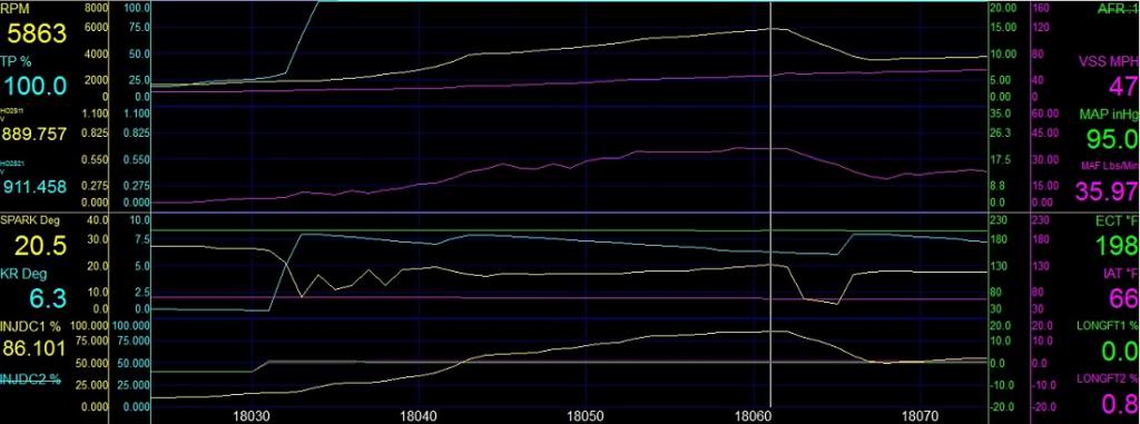

From what Justin said it seems like it just came down to the stock knock sensor values never got changed to compensate for how sensitive they are. So with the stiffer springs making more noise on top of it all, I'm getting a bunch of false knock. The truck got flashed back to factory when the shop I took it to started the tune. So they must have never changed those values, among several other issues.

Well I just wanted to post an update now that my tune is in Justin's hands once again. MUCH better is all I will say. Ill let the logs do the talking lol. Just take note at how much quicker I go through 1st gear in my newest log over the bottom one.
Here is one from today, it was roughly a 30-75mph pull.

And here is one from before.

He definitely knows how to tune these trucks! He says I'm about maxed out(aside from injector), but could benefit from a few more rpm up top. Right now it's between 6-6200. So probably take it to 6400 max. Not sure if I'll even bother honestly.

did he turn them off of just down a bit?
