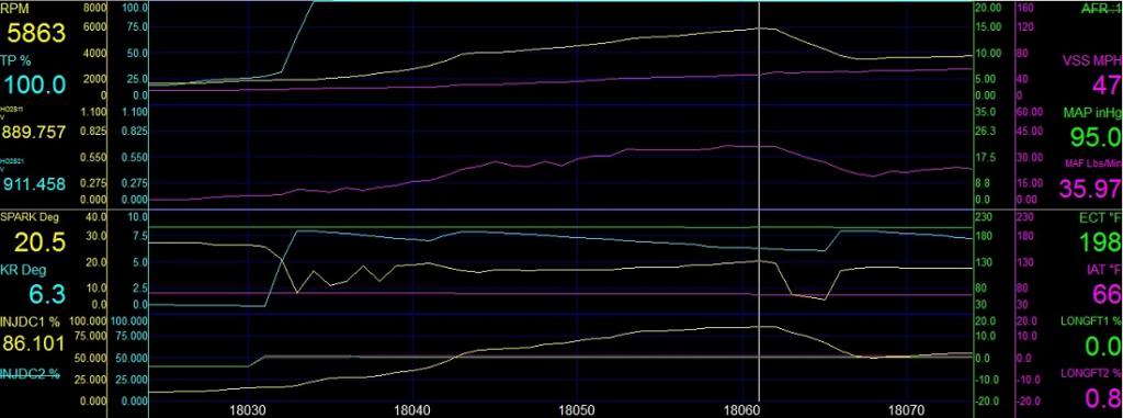

Here's a screen grab from the data log. Same screen, just the points shown are at the 2-1 downshift and the 2-3 upshift.
downshift
upshift
