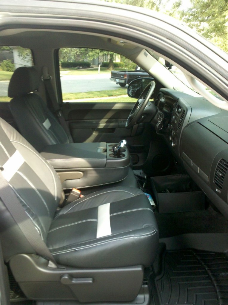

And yes, the Katzkin was worth far more than the $550 I paid and my labor of most of a weekend to install... I absolutely love it!
