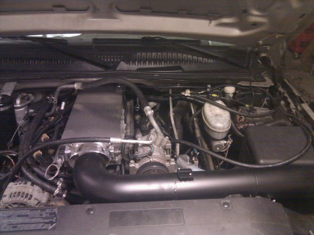

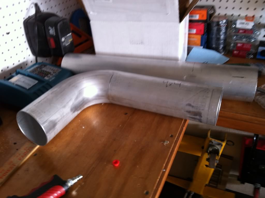

Finally all the peices are here. Hopefully i get everything installed this weekend
