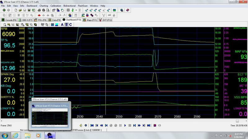

Ok so swapped the 6.0 in place of the 5.3. Bought a brand new Xlink and used TB and from the get go had REP mode with the used TB.
So I bought another TB and hooked it up and everything was great! Fast forward a month and I change gears in the rear and go do some logging and truck starts going into REP at the top of 2nd or Middle of 3rd but it was never a cosistent rpm/mph etc.
Well I've just been babying it but have done a few hwy pulls and now it seems to be doing it more and more. I've read through a couple of threads but nothing that compares to mine. With the first throttle body it would throw 2 codes (can't remember right now) but since it's starting to do it again I don't get any codes except some EBCM performance BS that's always there
Here are some screenshots. My throttle never goes past 98.8% and then it starts fluctuating from 98.8% to 97%.. It will dip down to 96% sometimes and that's when it seems to set the rep but no CEL
EDIT: 87mm truck TB

^^ This log here it actually hit rep in 3rd gear but throttle was 97%??.....

that TPS is normal with the Xlink and bigger TP...
Post up your tune and get a log with GM.DYNAIR if your SD or GM.MAF if your running a MAF...

Like said before, post up your tune. What are all the mods to the truck? I ran into this, and from everything I have gathered my problem was due to pulling too much air though the throttle body. I dont think that is your issue here though.
First with key on, engine off place the pedal WOT and see if it triggers REP.

Who did the tune? I am betting your hitting the threshold on one for the tests. But then again i could be wrong.
Also what code did i throw when it goes into REP?

Your logging 35 channels, you need to get rid of alot of the PIDs to get the resolution up... Also you still need to log both of the PIDs i listed above.
