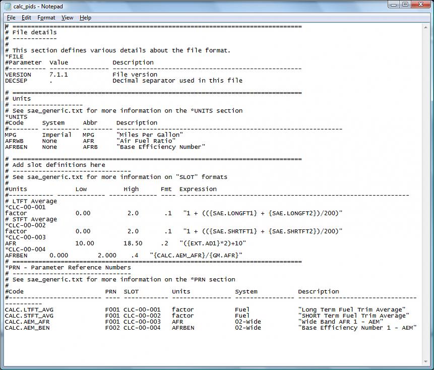

For those who have installed their AEM UEGO you'll need to create PIDS to make it work with your EFI Live.
All you have to do is modify the Calc_Pids.txt file. This file is located in your EFILive Folder under User Configuration.
If you have already modified this file with some other Pid information then your aware of the procedure, Just be sure to change the Slot Number and Unit numbers to not have more than 1 pid with the same number.
My configuration here has Long Term and Short term Fuel trim PIDS because I was doing some tuning using trims. You may want to just keep them in case you decide to go that route for tuning under 4k rpm later on.
If you have not modified this file before you can just save the attached txt file in it's place.

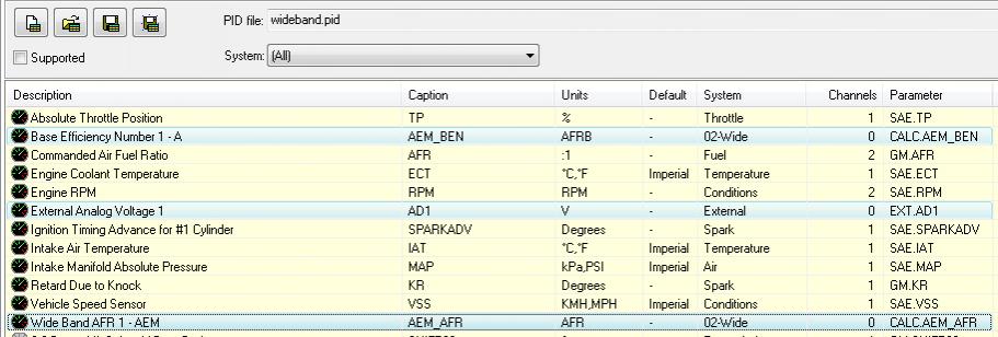

Here is a list of the PIDS I use when tuning. Wideband PIDS are highlighted.
I decided to add the Images as attachments just in case I move or delete them later and forget to update the thread.
Thanks to BlackGMC for getting me this information when I couldn't find it.
