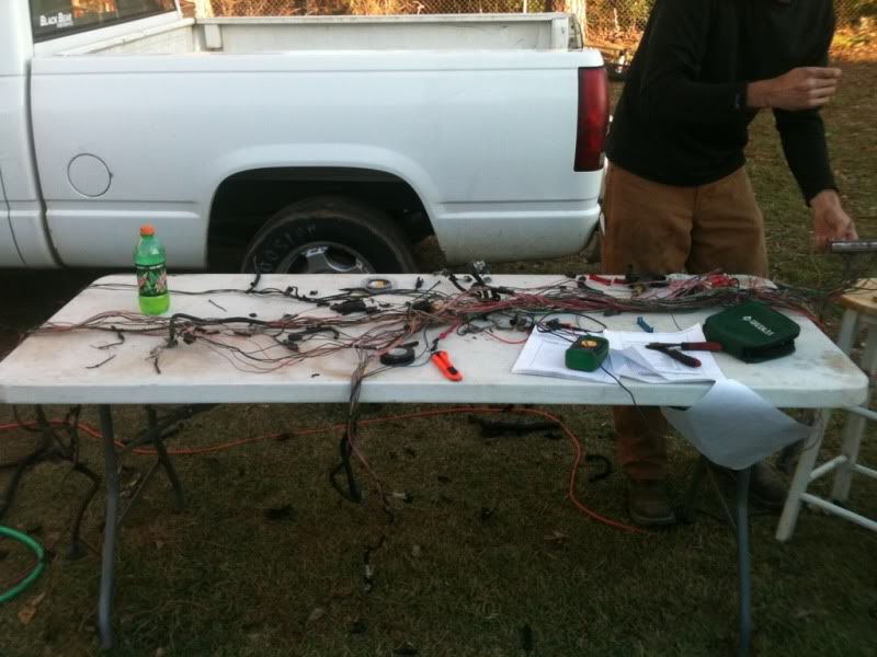

IF you have an LQ4 then the LY6 setup wont work. 24x vs 58X reluctor.
Ive made a few of them and the easiest way is to figure out what you want as far as sensors go.
on my Samurai and my buddys 98 w/5.3 turbo we run the very basics. No MAF nor Oxygen sensors for Speed Density.
PM me if you need help.
But strip the loom off, all the pink wires are Ign fused power, Orange are 12V+, Black is ground.
Vola.
i have all the PCM print outs on my photobucket if you need them.
Be amazed as to how many wires you remove.
Zip ties are your friend on this
Thats what we pulled out on my buddys truck.
