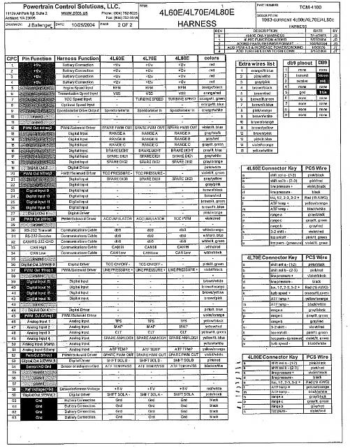

Here i scanned a paper i had in my tool box for a 4l80e connector i bought to diagnose tranny electrical issues without dropping the pan.

Take the 20 pin connector apart. Swap the brown wire and the white wire. Putthe connector back together and your done.
Pretty dumb to buy an adapter harness for any amount when its as simple as a 2 wire swap.
All your doin is moving wires so the lock up solenoid works. The polarity is backwards from a 60 to a 80.
Run two wires from the ISS to the pcm.
