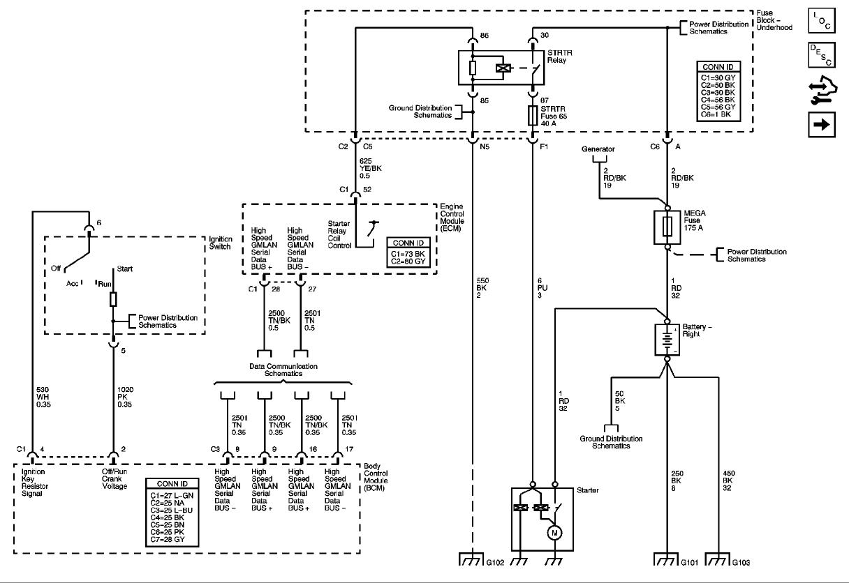

Have you changed the starter relay? Have you checked the 40A Starter Fuse?

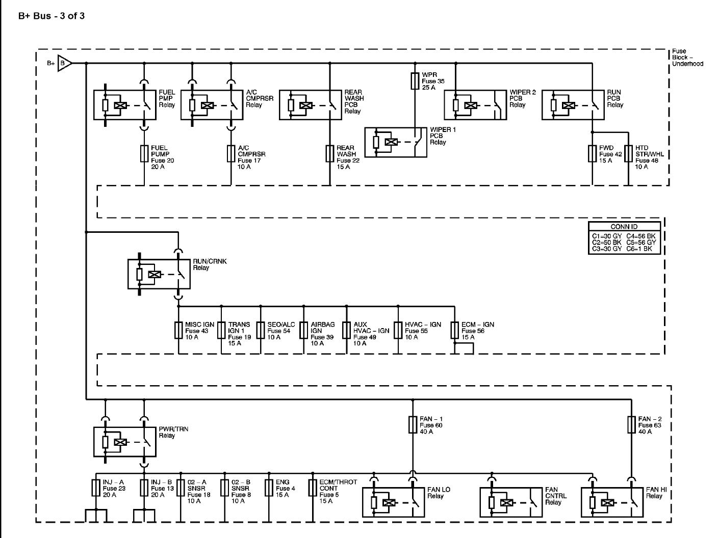

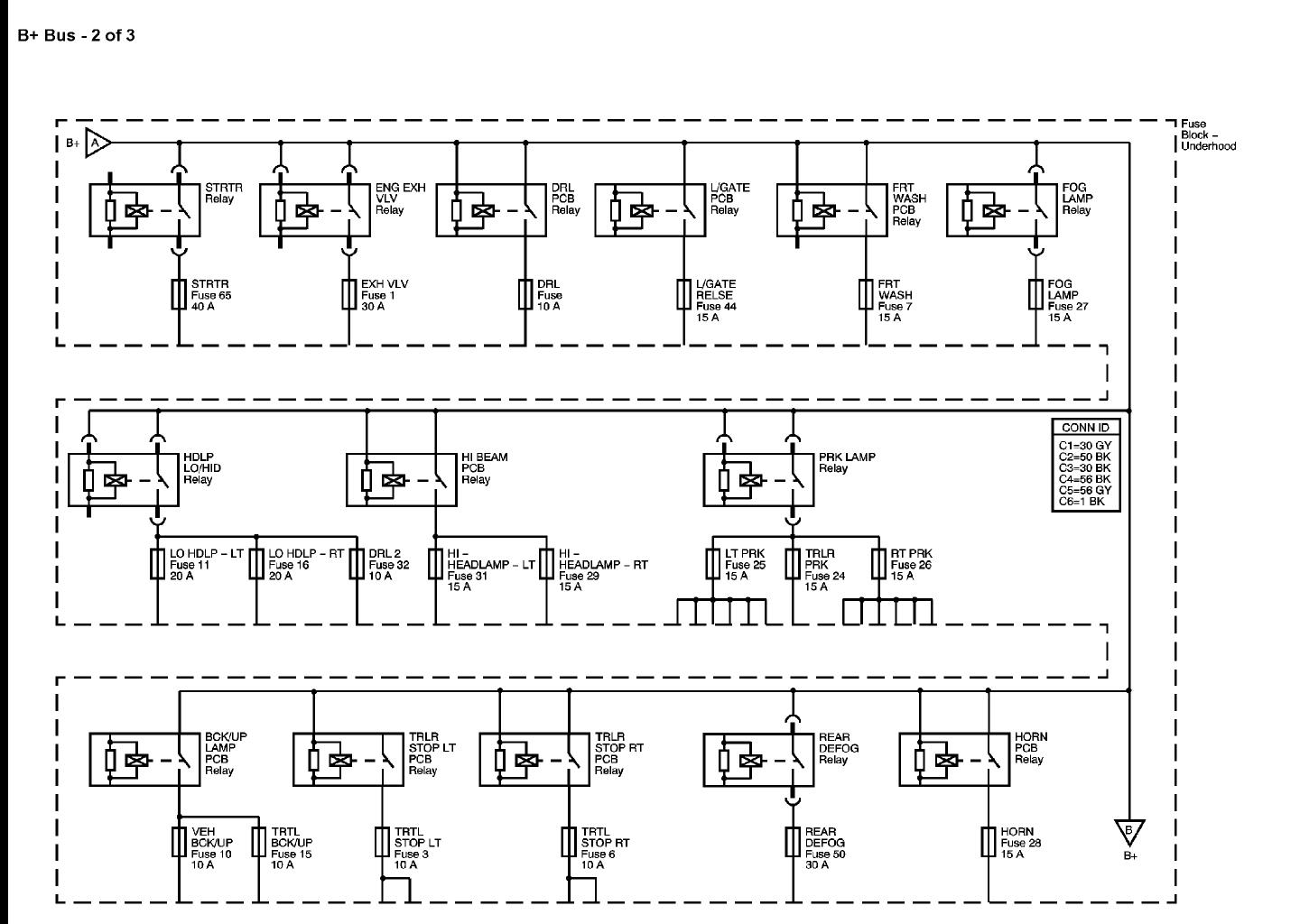

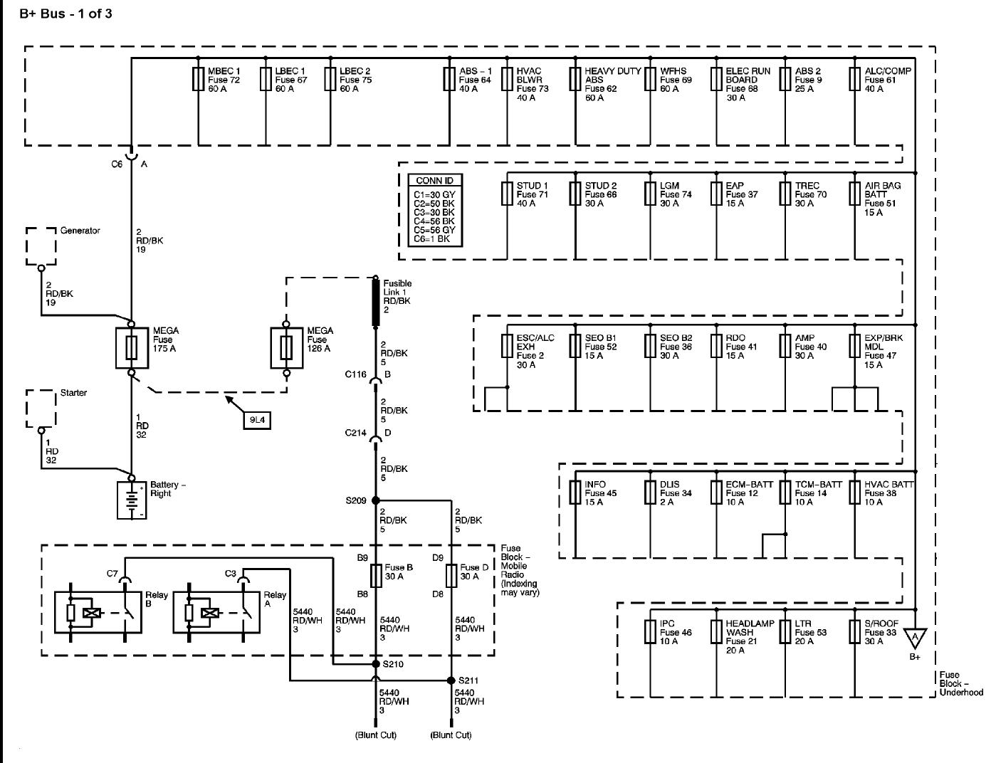

Some of the other functions you lost are common to the B+ Bus.
Attached Thumbnails 2007 yukon 5.3 NO Crank-07-yukon-b-bus-1.jpg   2007 yukon 5.3 NO Crank-07-yukon-b-bus-2.jpg   2007 yukon 5.3 NO Crank-07-yukon-b-bus-3.jpg
