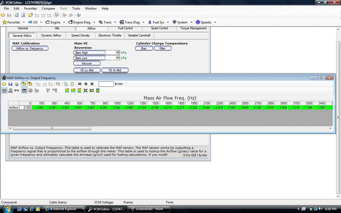

Check this.

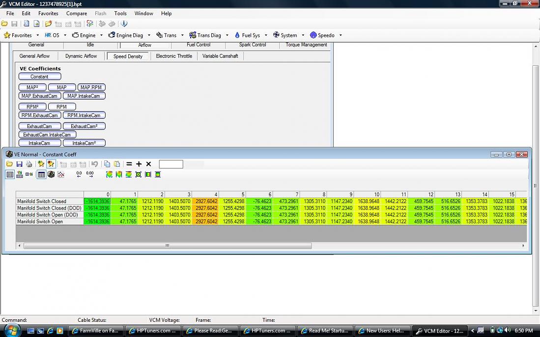

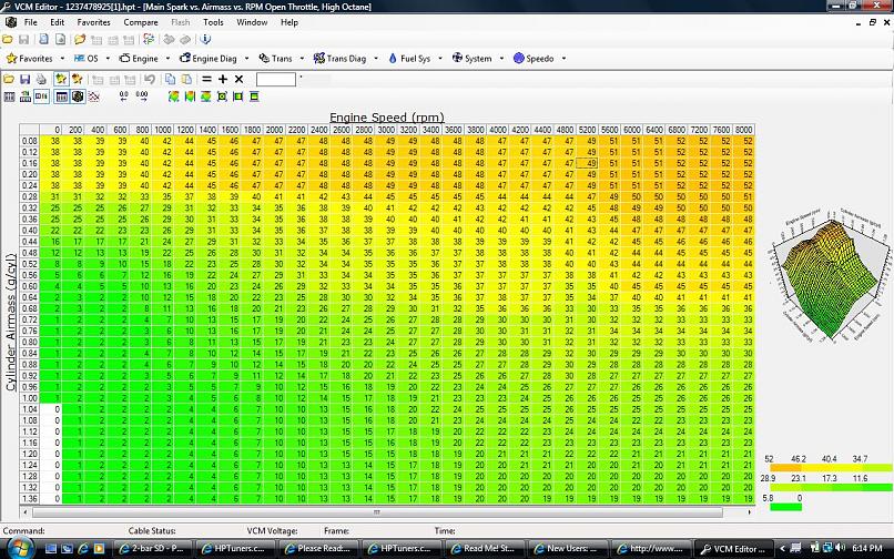

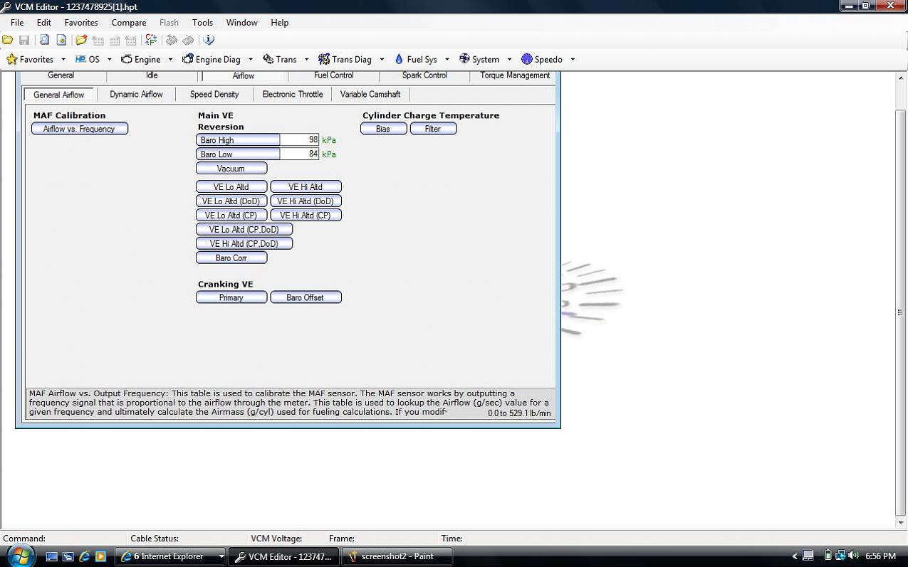

And this.
Attached Thumbnails 2-bar SD-screenshot2.jpg   2-bar SD-screenshot4.jpg   2-bar SD-screenshot3.jpg

Now that just pisses me off, the factory is running 20º timing at 4000 or so, where I have 15º. I know I should not be comparing timing unless the engines are identical, it's a bad habit. It's nice to see that the graph is as lumpy as mine, though. I wish they would get version 2.24 going so I could look at these late model tunes, and maybe tune my buddy's Dodge.
Thanks.
