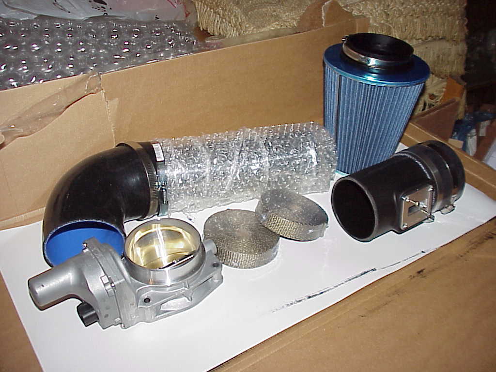

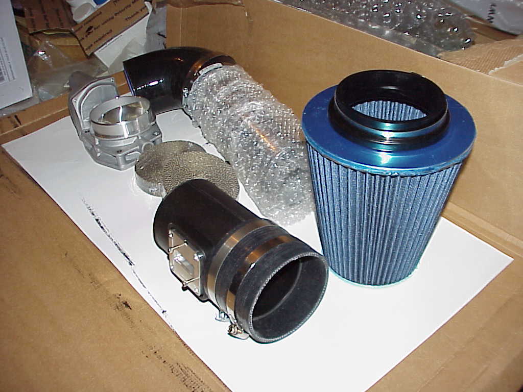

I did a 4" Maf and CAI and 90mm TB
swap on my 6.2, you just need to
adj the PCM for it.
Attached Thumbnails '18 6.2 truck to 6.2 Camaro maf swap-cai-1.jpg   '18 6.2 truck to 6.2 Camaro maf swap-cai-2.jpg

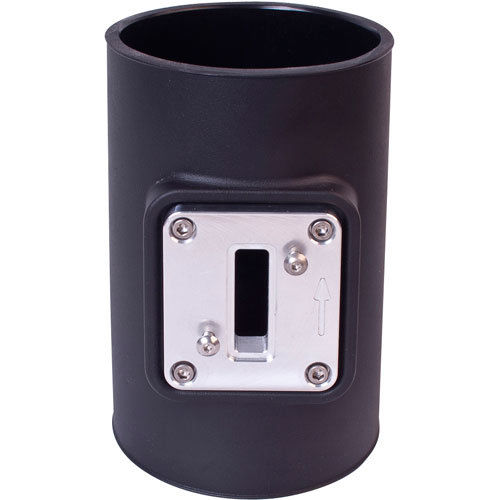

It was a PNP for the LS3 setup i built, just made
the adj in the PCM. they sell 4" MAF tubes
on e-bay
Attached Thumbnails '18 6.2 truck to 6.2 Camaro maf swap-4in-maf-air-tube.jpg
