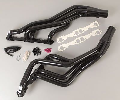

1.
are they any good would it make the engine bay hotter?

I have the coated pacesetters and I've been happy with them so far! Decent improvement performance wise and they sound good. My engine bay seems to be the same as before with regard to engine bay heat.

If those in fact are the headers you're interested in, they will not work on your 4.8L. They're for a Gen II or older smallblock.
