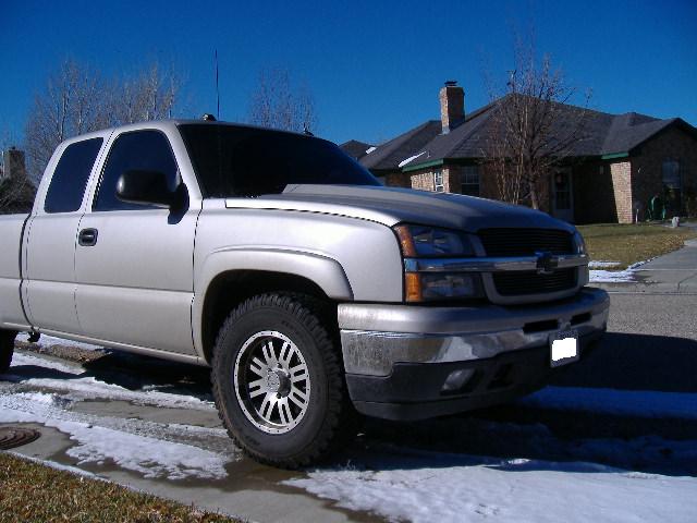

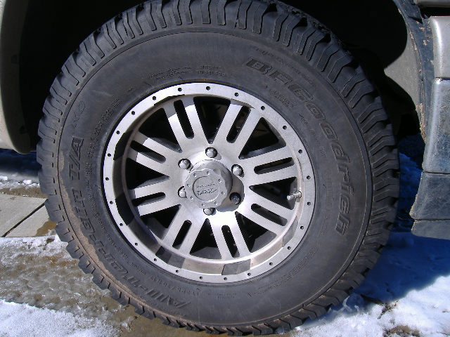

It just snowed yesterday so the truck is not clean.

Originally Posted by Onetogofast
Attachment 43216
Attachment 43217
thats not snow.... someone just spilled there slushhie
