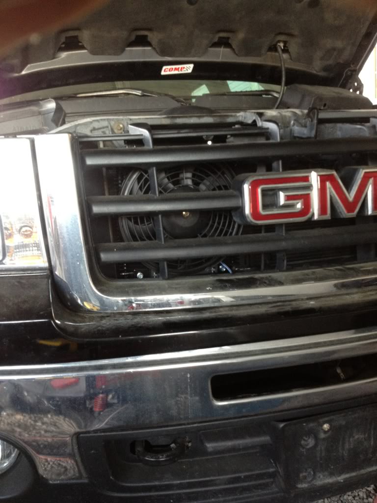

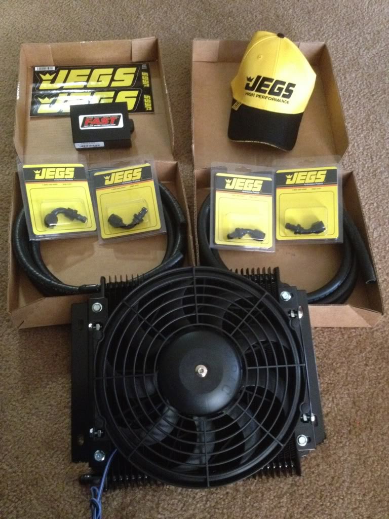

My 30K came with a fan on it and I got the T-stat that turns fan on at 180* one off at 160*
Mounted
