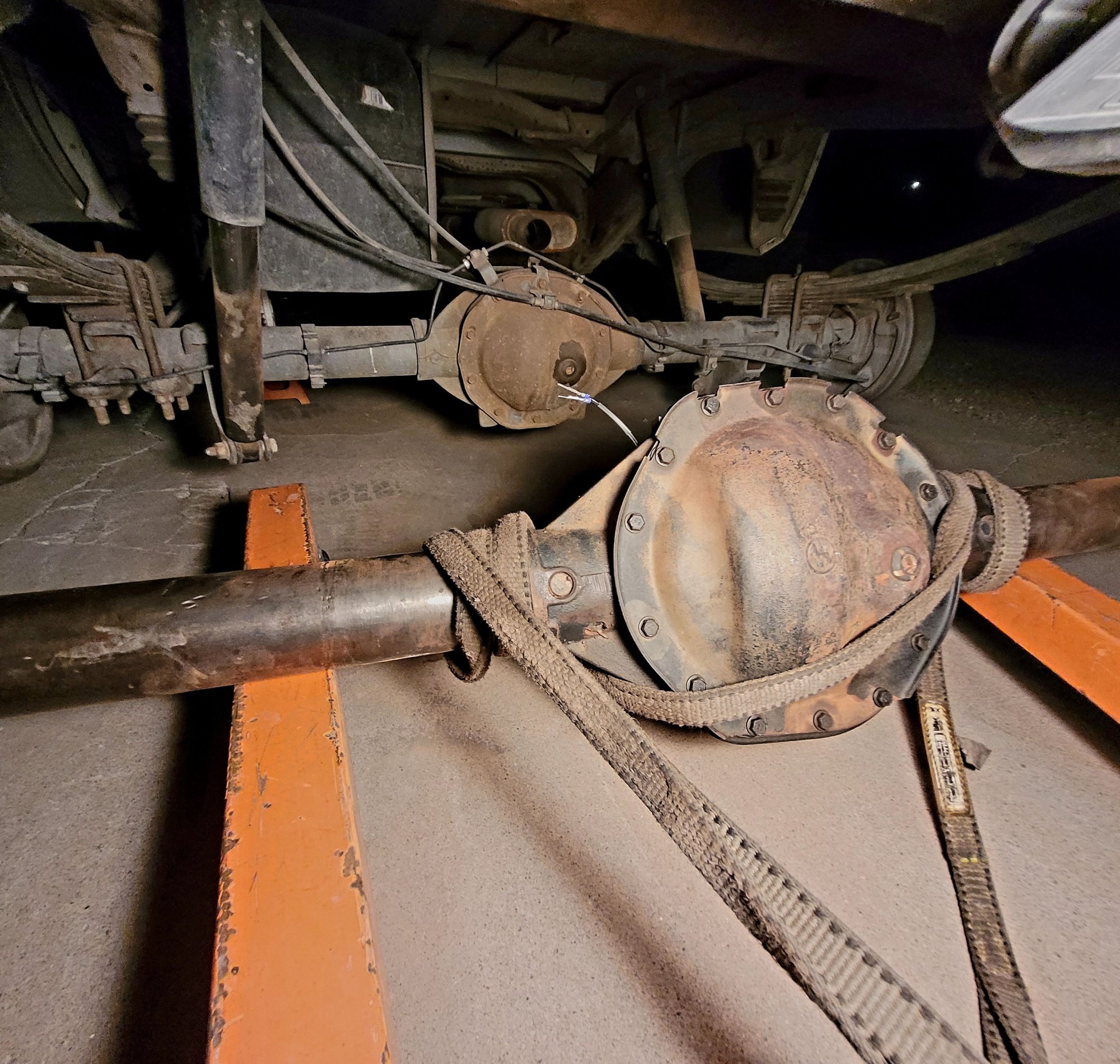

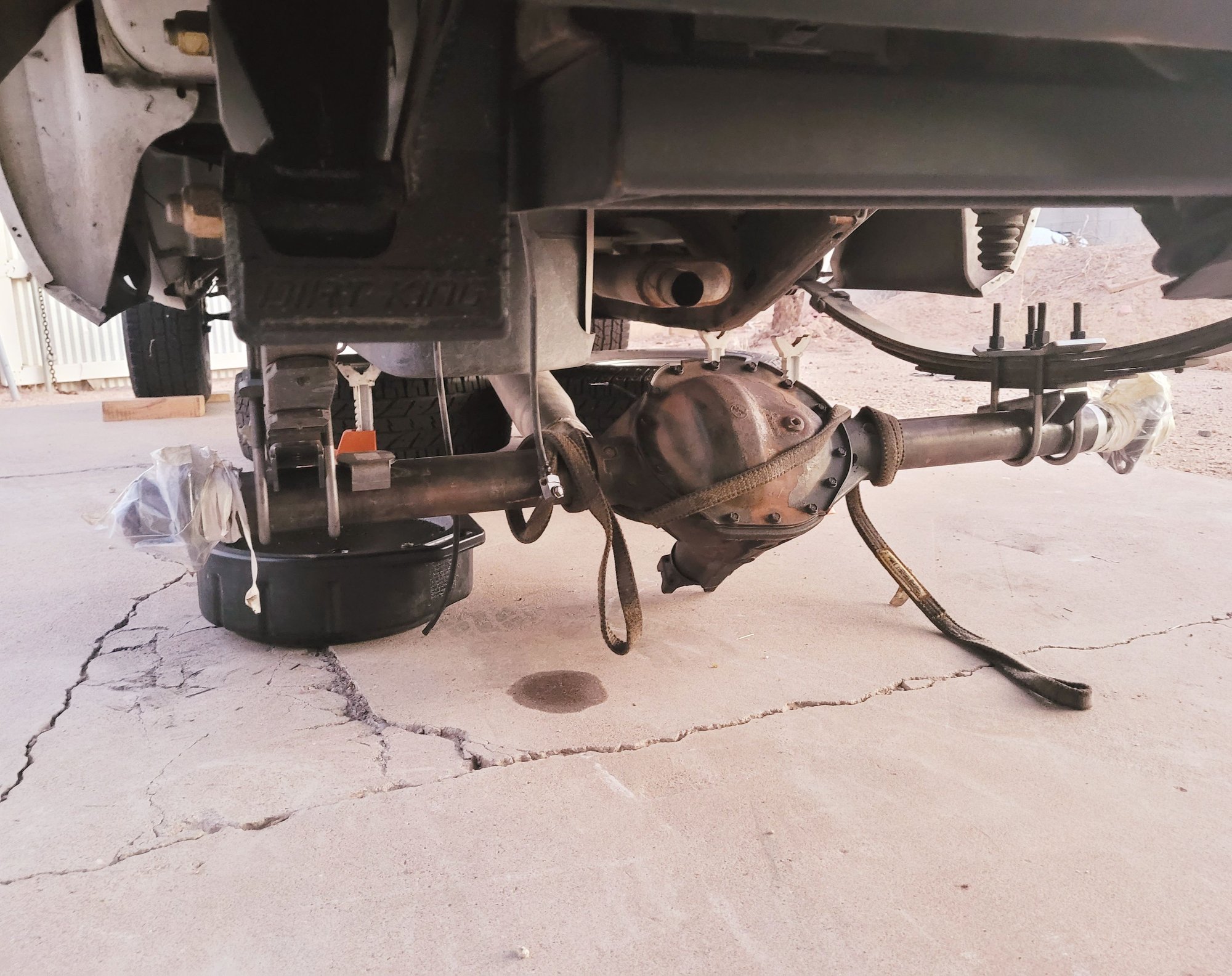

14 bolt SF
Swapping a 14 bolt 9.5 in the silverado. Hummer H2 housing, E locker, 4.56, dutchman 6 lug axles. The housing is wider then the 10 bolt. I think it might be the widest SF 14 GM used. Pics of truck, 10 bolt still under it. Just finished up the diff yesterday.

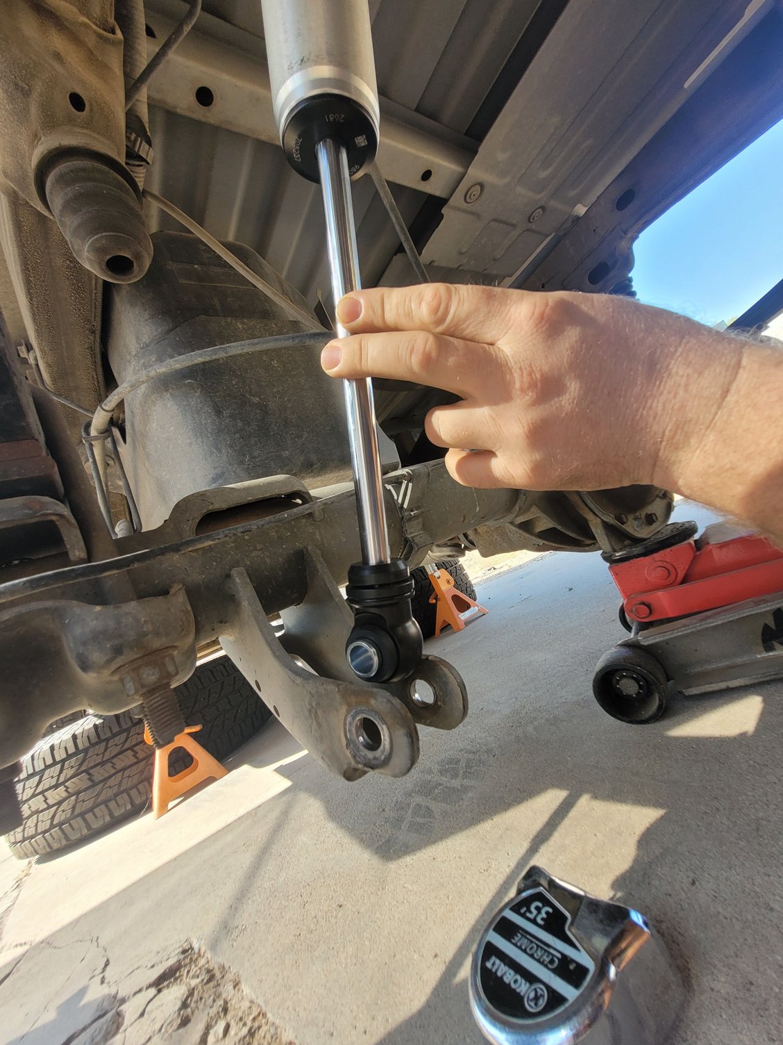

https://cimg2.ibsrv.net/gimg/www.per...583ac7a8a2.jpg
how much travel I'm loosing by using bolt in shocks

I still have to set pinion angle and weld up the spring perches. Also weld up the bump pads and shock mounts. Probably cut the shock mounts off the 10 bolt.https://cimg7.ibsrv.net/gimg/www.per...efe5ae162a.jpg
How it currently sits
