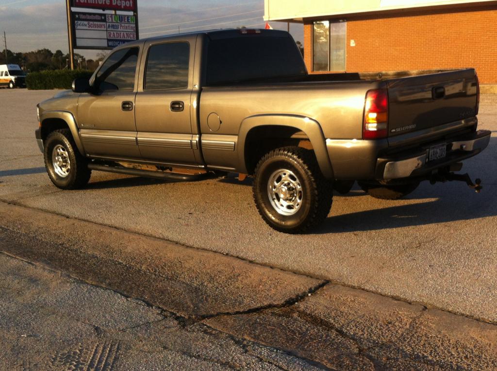

i run a a 285/75-16 BFG on my stock 2002 HD. the tires have been great.
And they look better than a 245 or 265.....
Good looking truck btw....
