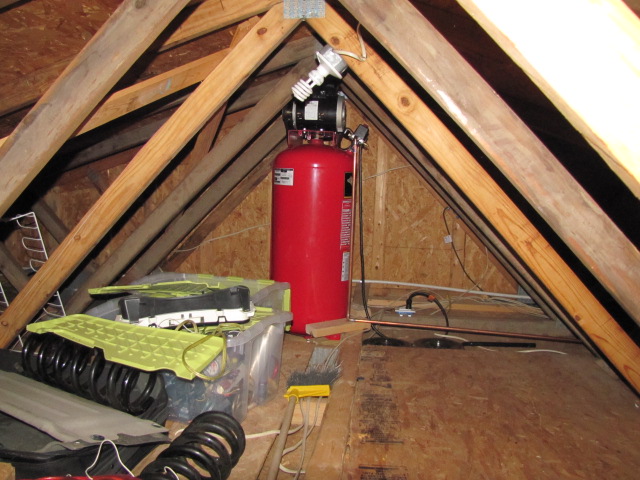

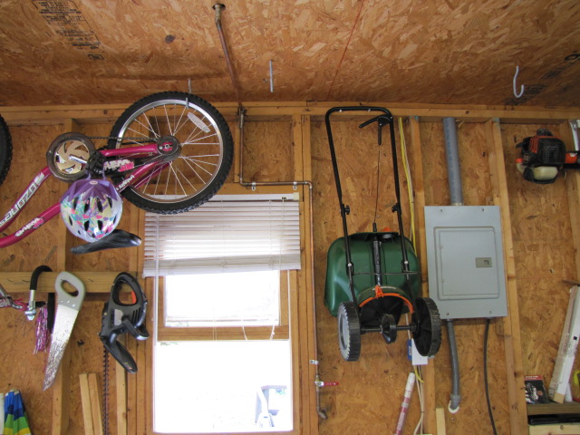

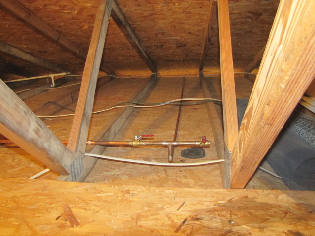

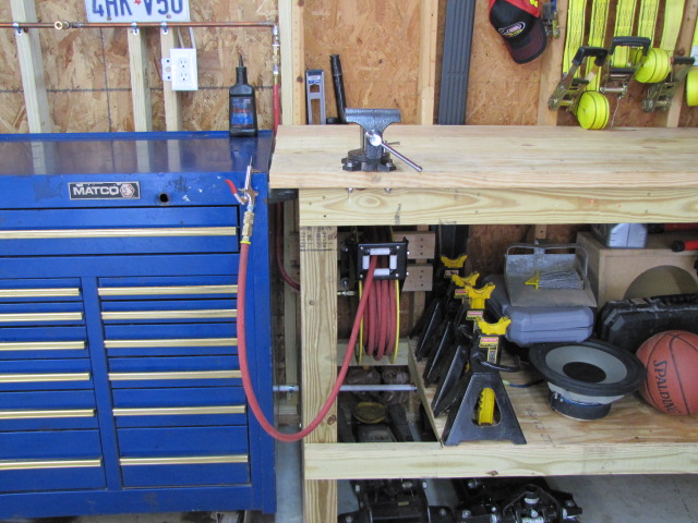

I placed my compressor in the attic this past spring. Ran all copper lines, and makes it much easier to drain the tank. Right now I have 1 30 gallon compressor in the attic, but I have a provision to add a second compressor so I have 60 gallon of operating volume. I'll take some pics.

Comes down from the attic. I have a pressure gauge, regulator, 2 additional ports, and then it goes to my hose reel. You can see the drain is plumbed in as well to a valve so I don't have to get wet when I drain it. Getting that bitch in the attic required me to disassemble the compressor.
