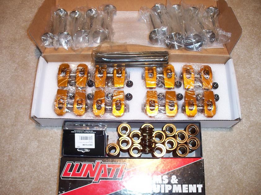

Got some deliveries today on parts for my head/cam swap in a few weeks. Let me know what you think.
HELL YEAH! Head/Cam swap parts are rolling in!-head-components2.jpg
Lingenfelter Valves 2.02/1.575
7.500 Hardened Chromeoly PR's
1.75 Roller Rockers
Lunati .660 Double Springs and pertinent goodies
On the way is:
Thunder Racing custom grind cam 219/224 607/600 LSA 111
Melling ported oil pump
ARP heads, crank, and cam bolts
160 thermostat
Powerbond 25% UD pulley
LS7 lifters
LS2 timing set
Pro Edge Street 3000 stall converter
Lingenfelter timing/launch controller
Friday delivery, more goodies. All I lack is the heads, cam, ARP balancer bolt, UD pulley, and converter.

Nice, what heads are those valves going in, whats the build going to be??
I bought a spare 5.3 and took those heads to be CNC'd, valve jobed, and milled. It's going on my Z71. I'm having the spare 5.3 block machined to LS1 bore and going to stroke it....... HA!, I said "stroke it".........to a 383. I know, I know, should've just went with a 6.0, that's what everybody says, but I just want to do this, say I have done it, play with it a while, and then maybe I'll move on. Who knows, I go through engines/mods projects like girlfriends, always looking for faster ones. LOL!
