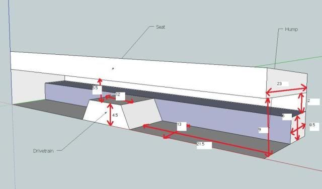

Old Dec 29, 2011 | 08:38 AM
blade7022's Avatar
Joined: Oct 2010
Posts: 141
From: Wyoming
This is what I came up with. If you have questions, feel free to ask. Keep in mind that if you are going to down fire it, you going to need to add some spacers to the bottom to give the sub room to not hit the floor.
