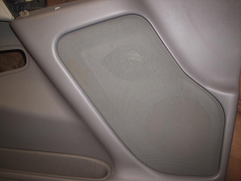

Unless you are going for high-end competition the door location will work fine. I installed some Infinity speakers into my 01 Yukon and they sound great. Just make sure that you angle them forward and up.
Here are some pictures I took of my install.
Every thing fit under the stock grill and cleared the inside door structure. Something to make sure of is that you run a crossover to the speakers. The factory tweeter has a very small resister on it that it used to cut out the low but the factory speaker wire that goes to it is just split off of the woofer wire so they get the same signal. I built a panel that I mounted my crossover too and mounted it low under the woofer. I used the woofer speaker wire to the crossover as my source.

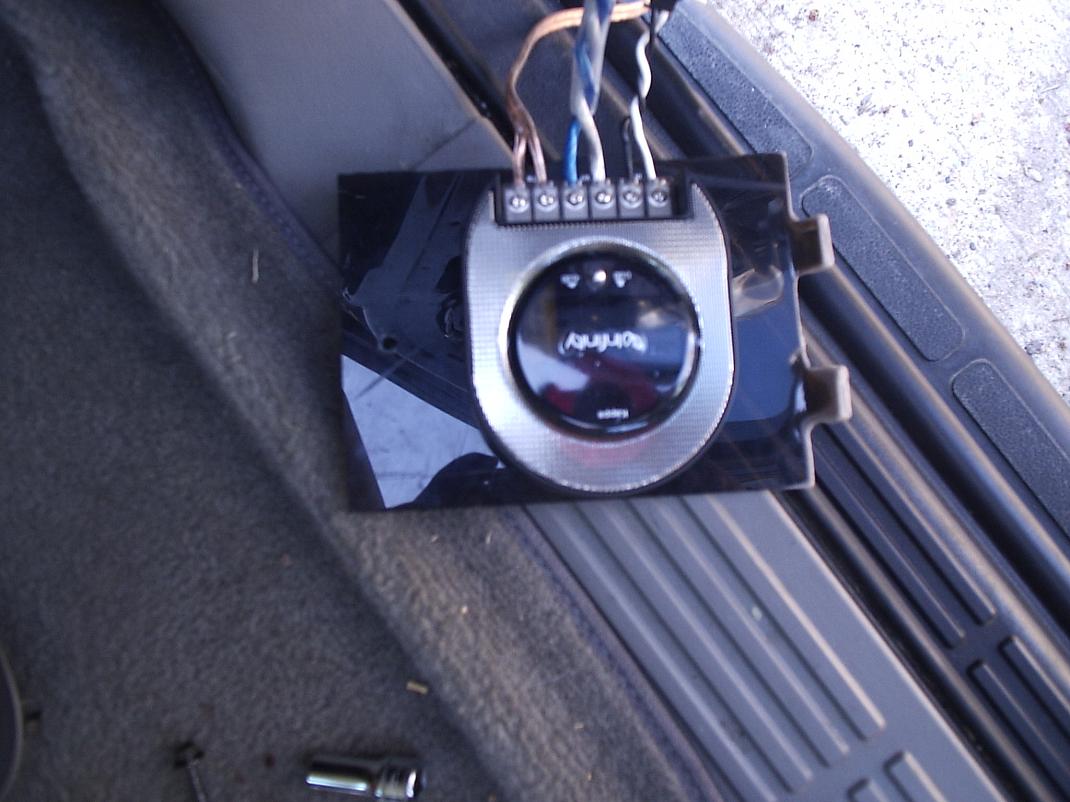

Here are some pictures of the crossover plate and mounting. I used a piece of smoked Lexan that I had laying around in my garage. I made tabs on the plate so that I could use the notches that the factory woofer used to mount on the bottom. That away I only used one sheet metal screw to secure the plate. Hope this helps you.
