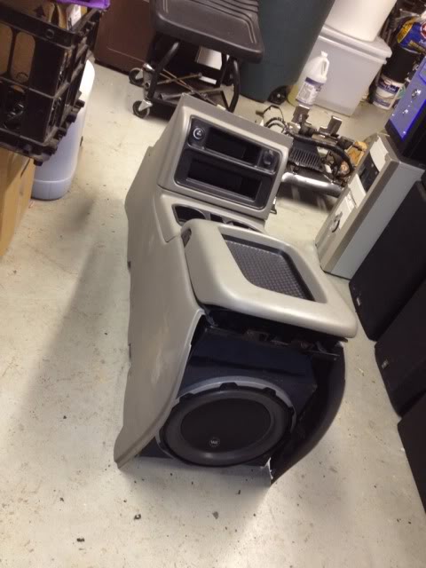

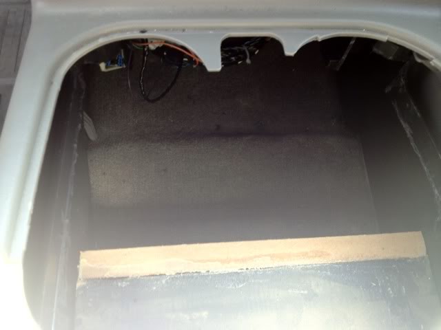

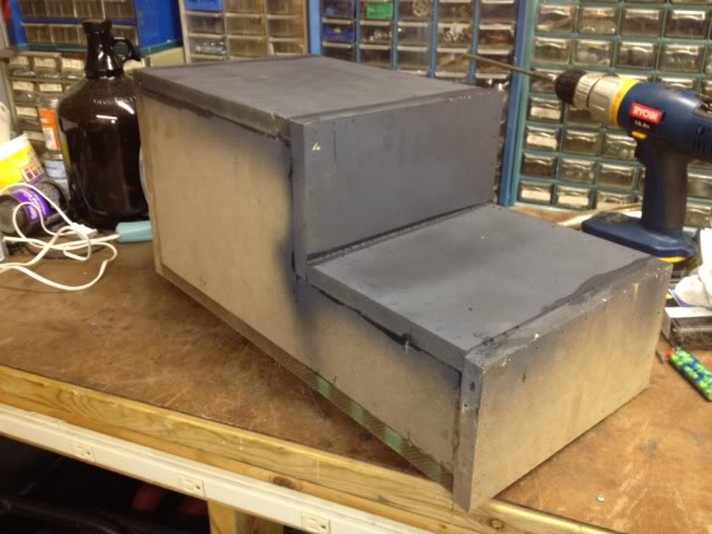

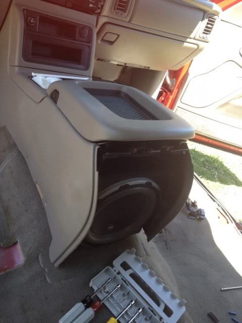

Truck in sig....I ended up with the full console from the factory. Because I wanted a system as stealth as possible I decided to install my JL Audio 10w6v2 in the console. I used my dremel and cutting wheel to cut all of the excess plastic from the console to fit my box. I went with a sealed box that is approximately .65 cubic foot to accommodate the subwoofer. Until I figure out exactly the direction I want to go with this box I just painted it flat black.

The reason for the step down at the (front) of the box is because I wanted to keep as much space as possible under the cup holders for storage.
After quite a bit of dremeling with a cutting wheel I was able to fit the box inside of the console.

It sits crooked in this picture because it was not installed in the truck and the height of the trim panels on either side are different.

I will take some pictures and post of the installed look with seats. The overall console was raised about an inch to accommodate the box. The part that kept the console from fitting 100% stock height I wasn't willing to cut. ( it would have deleted the latch for the arm rest so I decided to keep that) I have also fitted the rear fascia for the console that holds the air vents and cup holders. Both which were deleted due to space or rattles. Again I will post some pictures shortly of how it fits and currently looks like.
As far as sound goes all I can say is that im impressed. The JL 10w6v2 is a pretty stout sub. At full volume (amp limited) it will shake the steering column on select tones. Check back for updated pictures and let me know what you think!

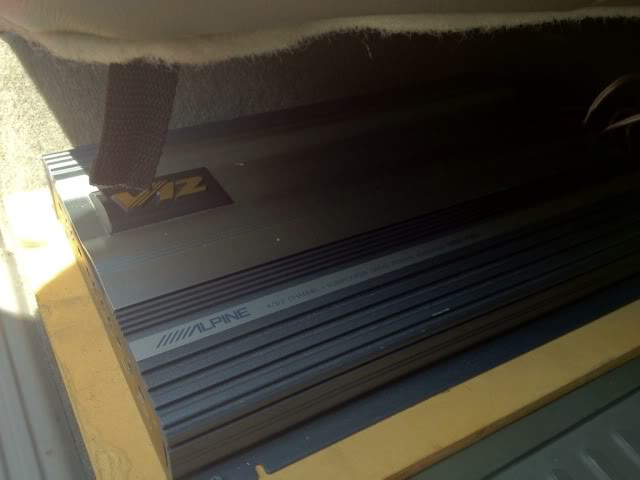

Thanks man! I am pushing the 10w6v2 with an old Alpine V12 MRV-F357. Its a 5 channel amp that I bought with the sub from a friend. The sub is being powered (under powered ) by the sub channel of the amp. It is only getting around 150w RMS and Peaks at around 300w. I have it mounted under the rear seat on the passenger side. I haven't put much work into the amp mounting because I have some other amps that I would like to go with. So until I get my final amps I won't spend much time on it but here is a pic.

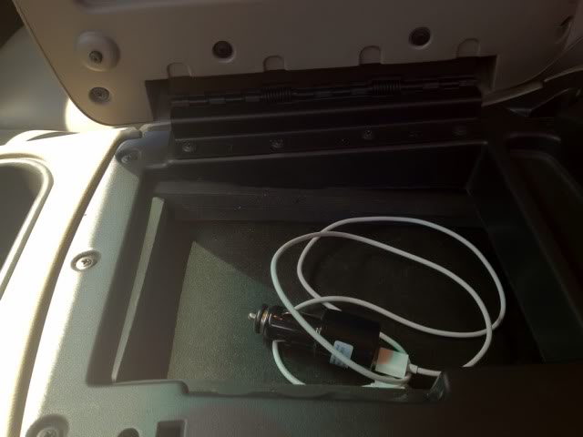

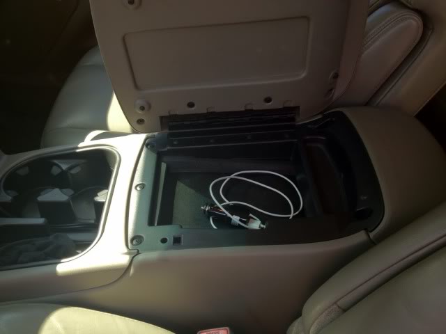

Thanks Man! Actually I have more space now than I ever did. The box did take up 90% of the area under the arm rest.

But with all of the Bose equipment taken out I have a HUGE space under my cup holders now.
