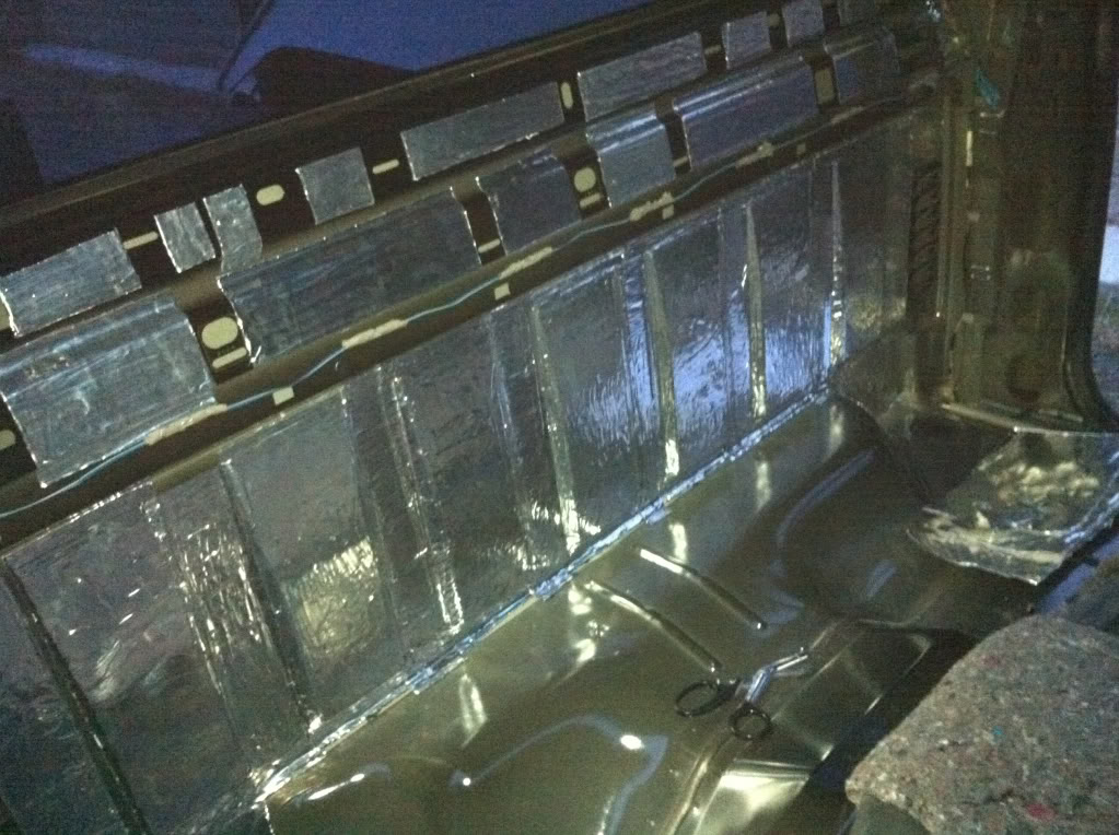

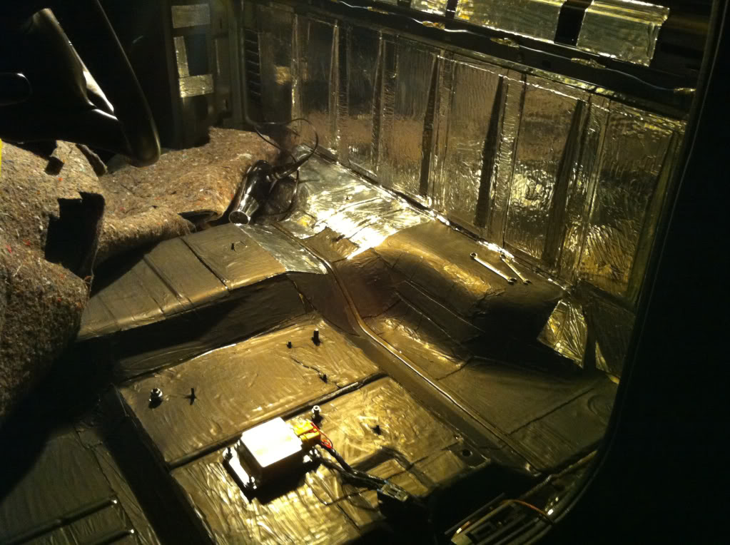

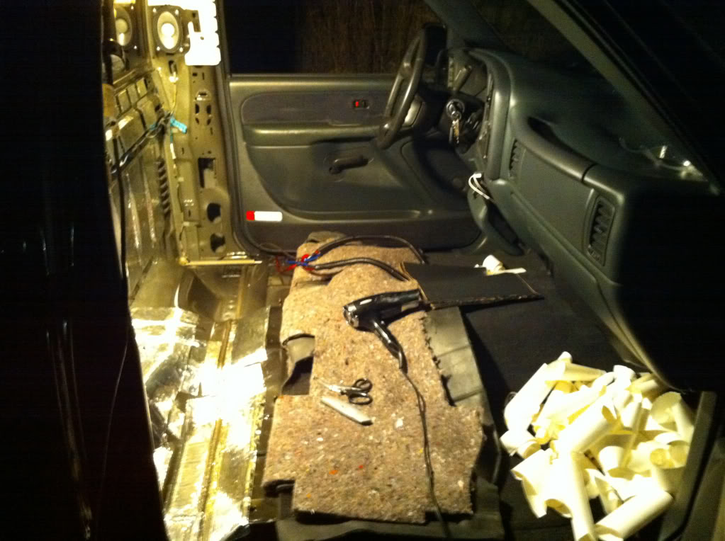

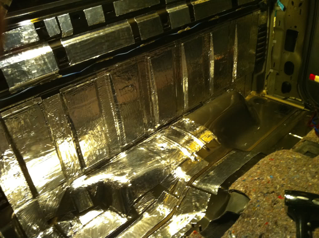

So the first thing I did was start the sound deadening process. I like to use Second Skin.
When I ran out of the silver backed foil I switched to the black.

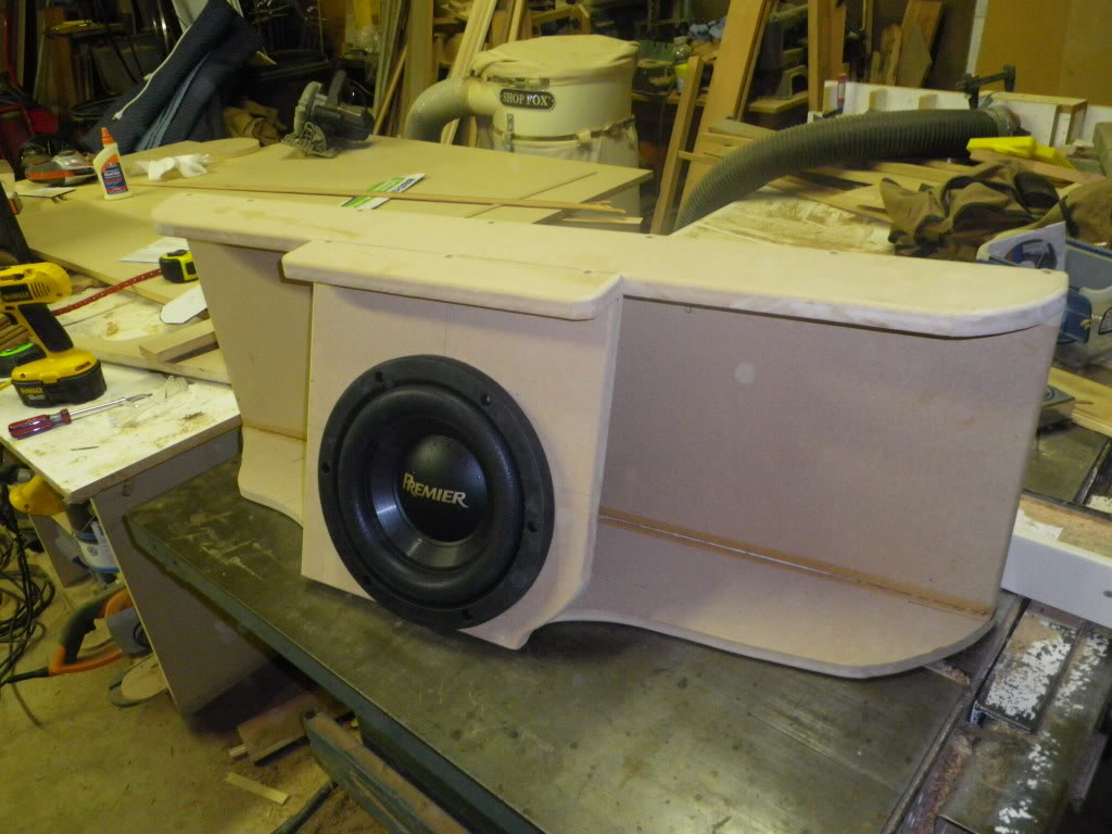

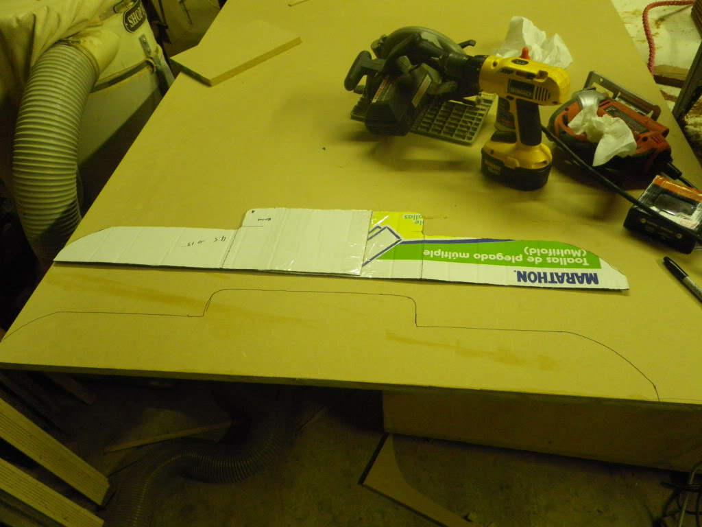

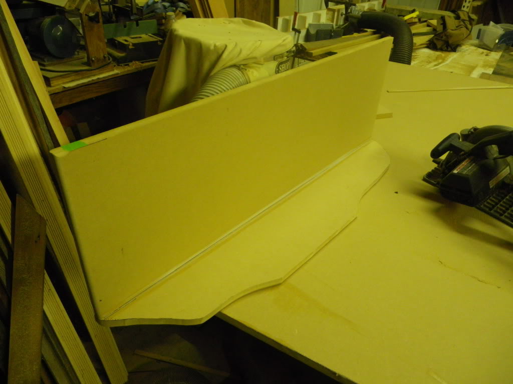

Then I built a subwoofer box.*
The first thing I did was start to mock up the bottom of the box.
Cut the piece out of MDF.

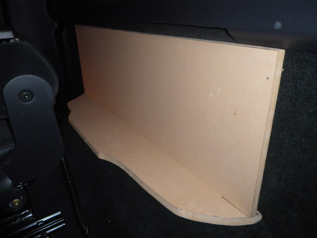

Measured and cut out the back piece of the box.

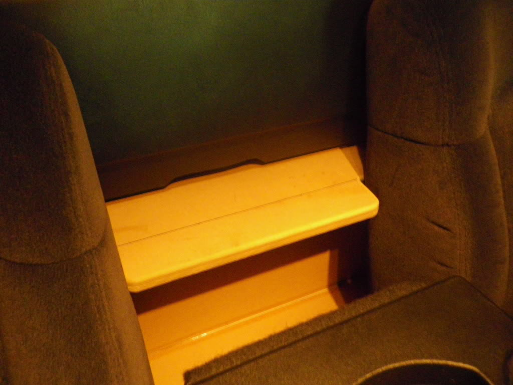

Test fit.

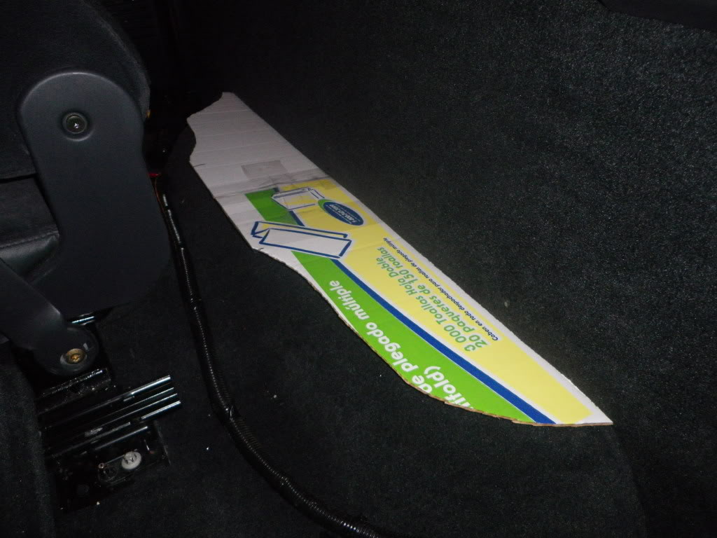

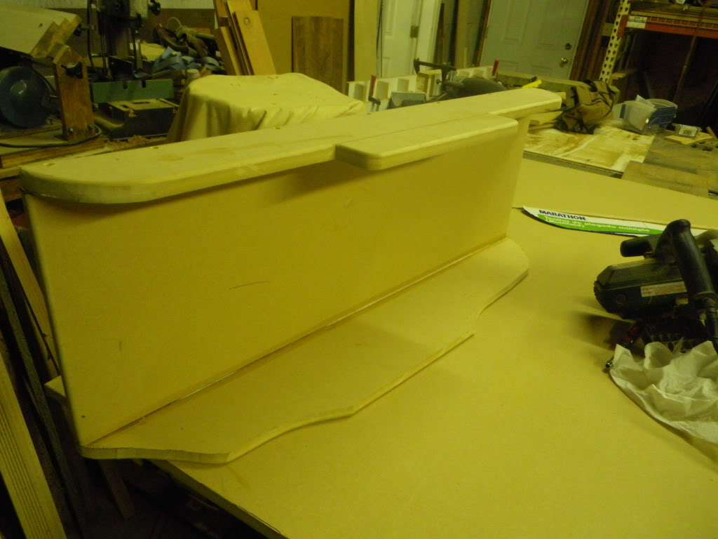

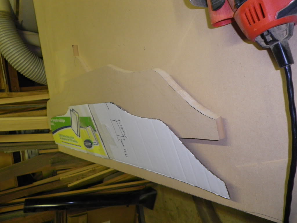

The next thing I did was put the two seats where I wanted them and then cut cardboard out around them. This will become the top of the box.
Then I cut out that piece and glued it to the top of the box.

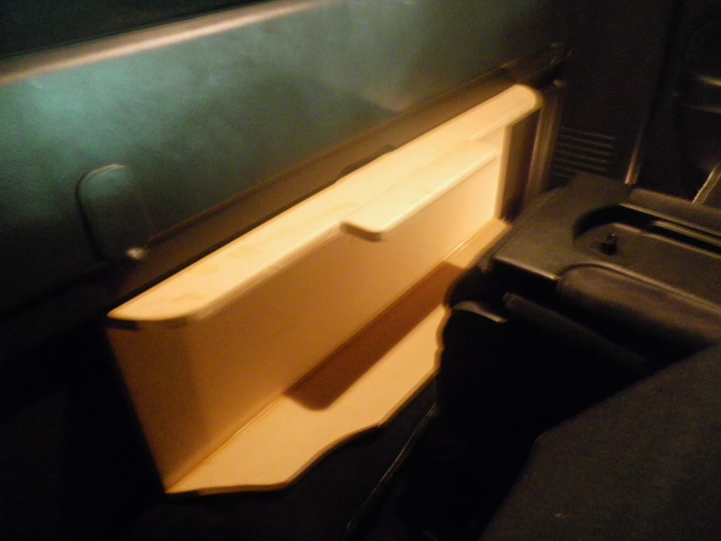

Test fitting the box.
Then I measured what space I had and cut a piece to that size.

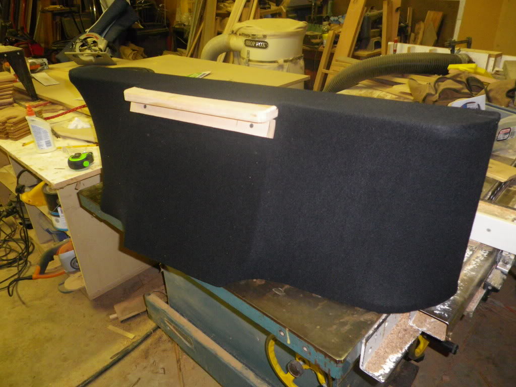

Next I covered the entire box in felt.

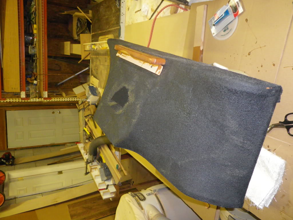

Then I mixed up some fiberglas resin and covered the box in it.

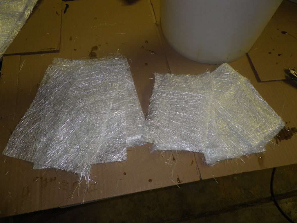

Then I cut up some fiberglas matting and started the process all over again.
I misplaced the next set of pics but you get the idea. *I covered the box over and over then used a bit of body filler and sanded it down until it was smooth. *I painted it with hammerite black.

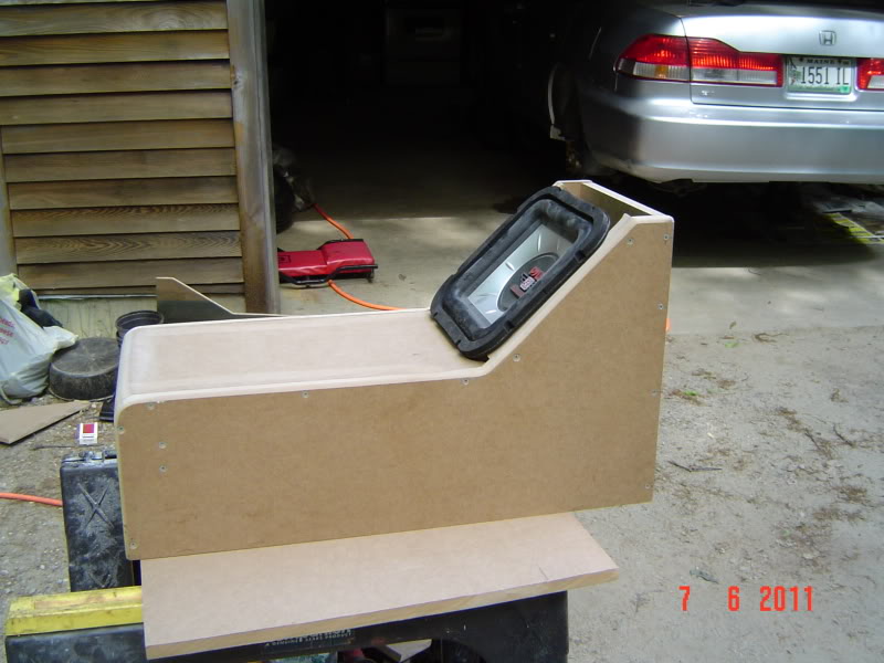

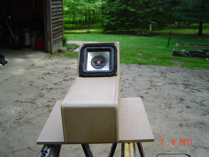

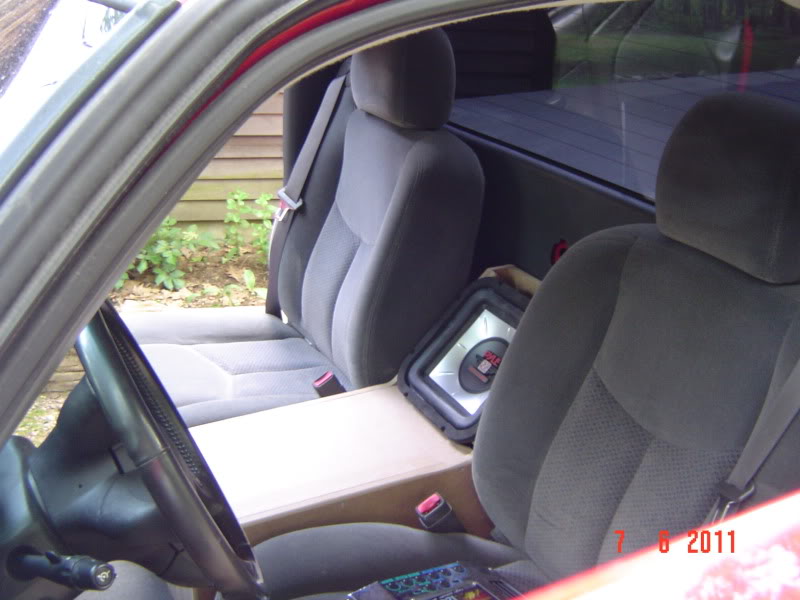

after seeing this thread and iregret's great work it inspired me to start my rcsb box build this is what i got done to this point
test fit/ still need to seal it and finish ether carpeting it or glassing it
