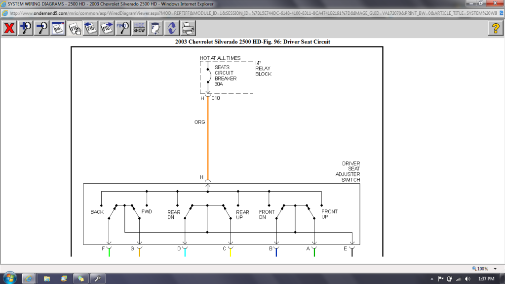

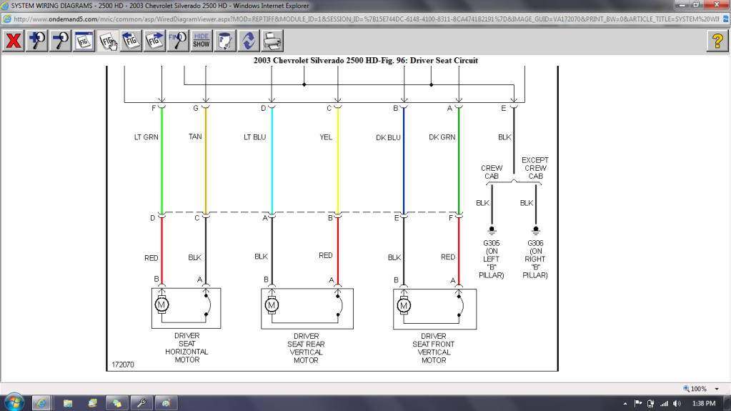

I pulled a set of buckets (power driver) from a 2003 gmc 2500. I am putting them in a 2003 GMC w/t 1500. Non powered seats. I am looking the wire diagrams to the plugs so I can wire up the seat switch and cor the power. Any help is appreciated.

Old Dec 29, 2012 | 04:40 PM
AKlowriderZ71's Avatar
11 Second Hall Moniter
Joined: May 2008
Posts: 11,651
Likes: 10
From: Wyoming
Old Dec 30, 2012 | 11:14 PM
BadMonkey's Avatar
Joined: Nov 2001
Posts: 4,336
From: Milwaukee, WI
Thanks, got it all hooked up. The seats I got did not have the provisions for the airbags on the passenger side so I had to relocate everything, was a pita. Good to go now.
