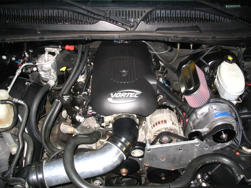

Here are 2 of them to choose from, one you still have access to bleed the rail if need be.
http://www.casperselectronics.com/st...x=0&search.y=0
http://www.casperselectronics.com/st...roducts_id=963
Look back to the right of the engine cover.. There is a bare spot on the wall.. That is where I went through with the boost line, FP line(this is older pic, didn't have the FP line ran yet) But it is right next to the boost line, with rubber grommets.. A bit of a pain, but well worth it, looks good aswell..

The holes come out in back of the dash board, from what i remember, it is pretty clear in that area back there, but still make sure you don't go crazy and blow through the wall with the bit... I fixed the link, but they are only showing the T now... Hey it is 16 buks, but when you need it you need it...

I used one of the nipples that is sticking out of the intake..
