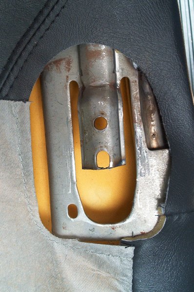

type x's arent cheap i heard . also how is it that people have said you can make the seats in a extended cab fold down flat like a crew cab . i know its off subject but u seem to have experience with these things . its a pain having a big yellow lab and the way the seat is angled you know nice if it folded flat .
Trending Topics
I took a pic from GMFS and did the same thing to my seat, You cut right around the bottom hole on the latch and it allows your seat to fold down when the bottom is folded up. The seat is sill able to be locked in place as well. You have to remove the middle support cable for it to function. I used a sawzall and it took all of 5 mins,

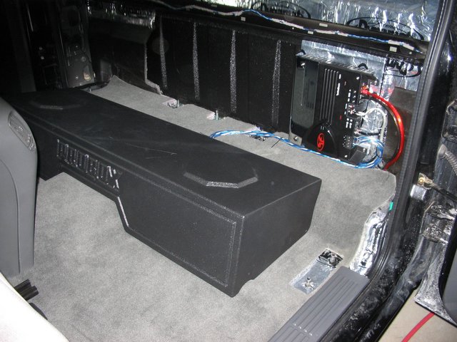

her's my 2-10's down firing box I using now.
