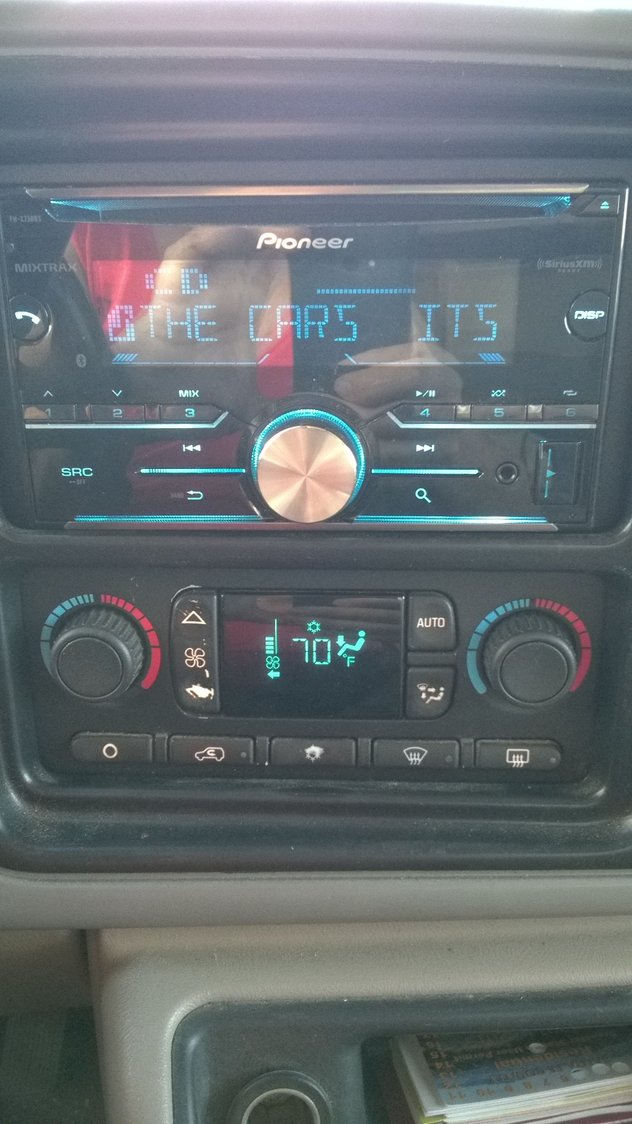

K guys- this is where I'm at now. Got an HU and X11 controller and went together well, I chose this one as I thought it best blended with the original display best. Actually sound a bit better than the original HU.........
Old Mar 20, 2018 | 11:13 AM
Tayj6's Avatar
Joined: Mar 2018
Posts: 66
That actually doesn’t look too bad with the color being close to factory lighting...if that center **** was black it would really blend in. I have married my 2002, so I’m stuck with 1.5 DIN opening, so I did the PAC add in and just run any audio I want through my phone...although I’m getting old so I find myself listening to more and more talk radio.
