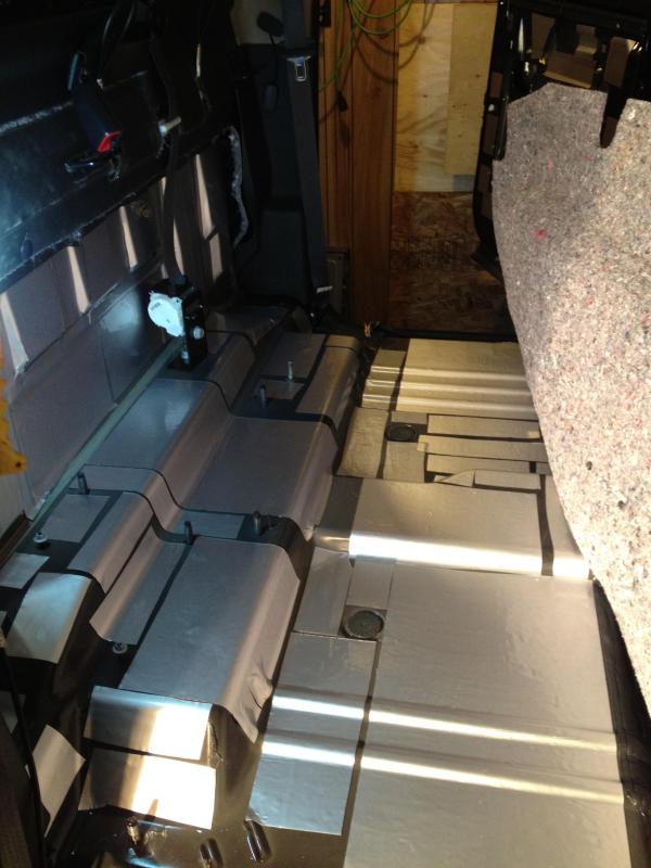

i used some thin underlay.. think 1/8", painted it black and mounted equipment to it after securing to the back wall. and sound deadening...
Nice amps. Ive got an MCD-1000 and a Memphis Belle that Im thinking of putting in my truck.

BTW, how did you secure the underlay to the back wall? I have done this before but used screws through the back wall. I dont wanna do that to this truck though. Any other ideas?

300.4 and a 1500.1.. they've been used for years in different vehicles, very nice amps. i secured using screws imagine you could probably use some thick 2way foam tape?
I have 2 amps mounted to the back like in the picture. I used some 3/4 mdf that I had left from the box and used L brackets that i attatched to the mdf then used screws throught the floor and the piece of metal that extends out just below the back window. That way there are no screws going through the back wall.
Some people on gmfullsize have used industrial velcro to mount the amps.
