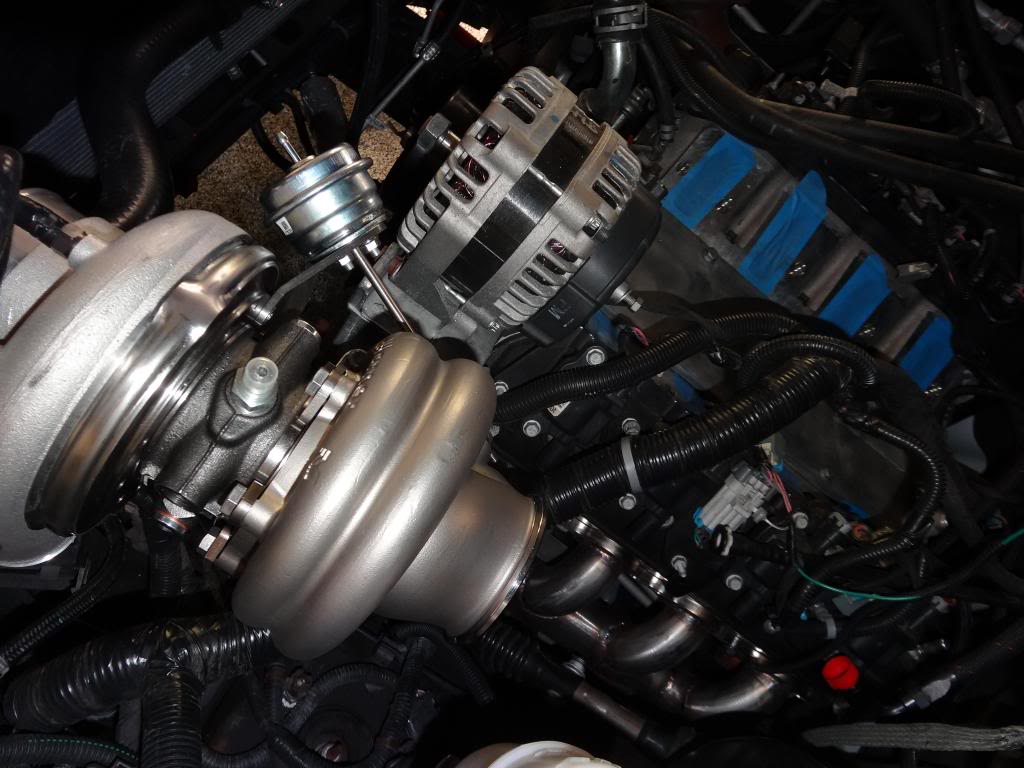

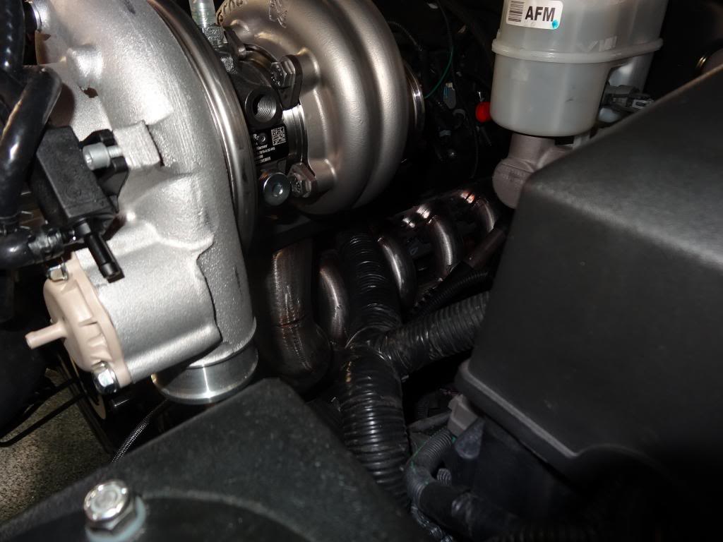

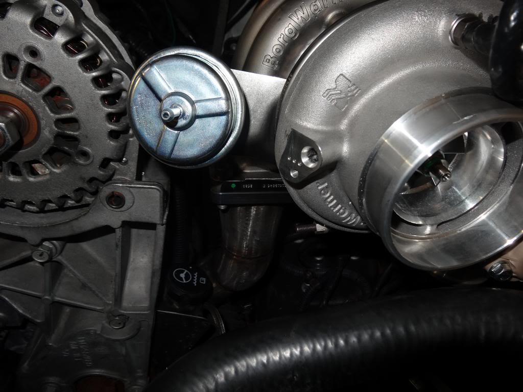

Here are the turbos we selected to build the kit around, these are Borg Warner EFR 76/70 turbos with high flow internal wastegates and bypass (recirculation) valves built in. These also have stainless exhaust housings, built in boost control solenoids, and EFR turbos contain wheels that are fully milled from forged aluminum, commonly known as “billet”. Cut from custom
forgings, their strength exceeds that which is available from typical bar-stock and also exceeds the material properties of an aluminum casting.

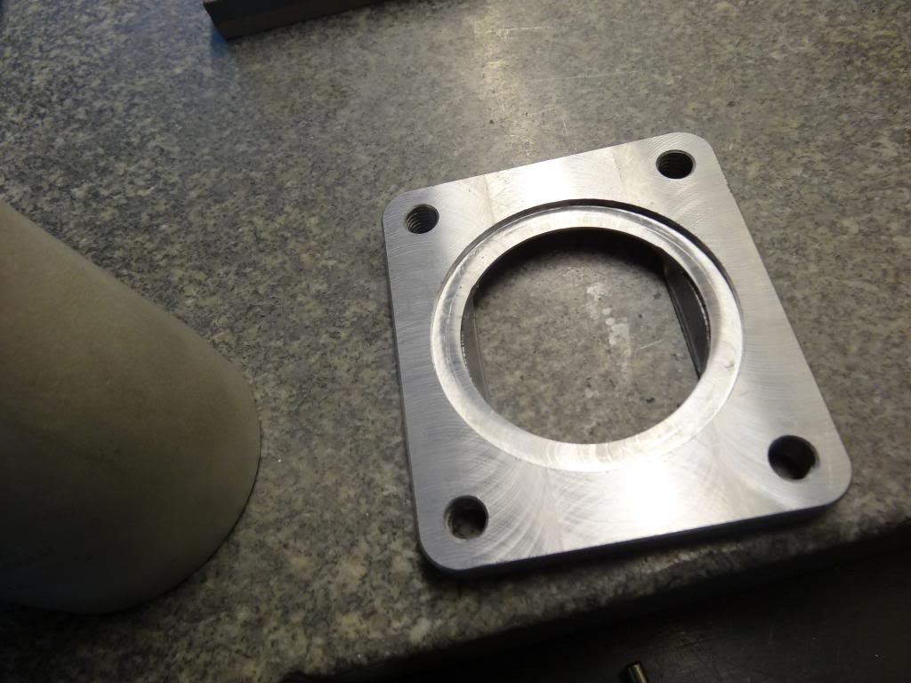

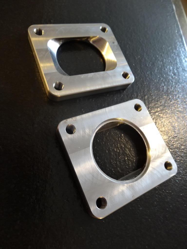

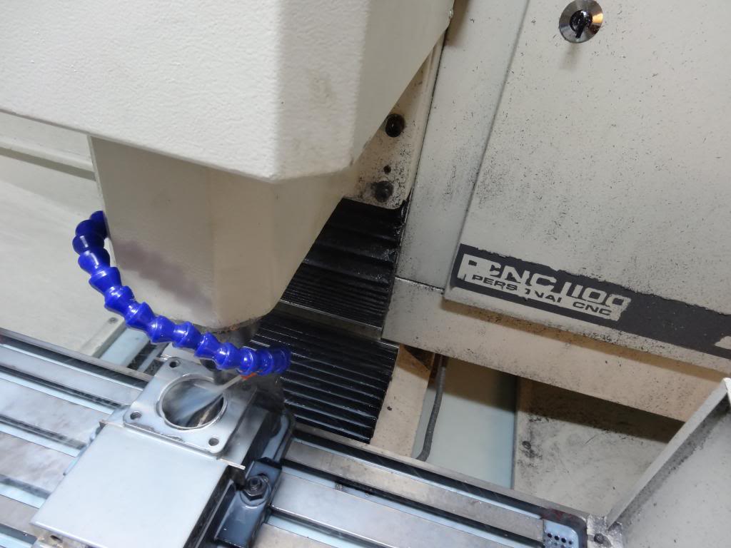

We found these T4 adapter flanges online, but we are using larger tubing with the schedule 10 tubing which is a somewhat unique size, so we had to set them up in our CNC and open up the slot diameter, the inner diameter will get ported once the manifold is complete before final assembly.
