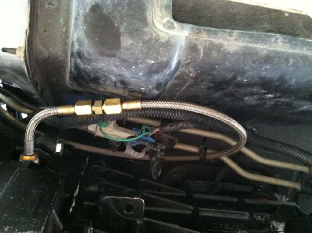

NEED SOME HELP GUYS.. got my clutch installed but cant get it to engage... I installed 24" speed pleeder with check ball valve bled the damn thing for 45 min Ik the thing is bled right.. used some aqua hose to feed fluid back up into master cylinder.. but with engine running and clutch pushed all the way to the floor it wont go into gear. with engine off it will go into gear fine but when i push clutch in truck wont move. ik its not binding anywhere, when in neutral truck will roll fine forward or backwards.. im at my witts end. I've had the tranny out 3 damn times now.. first to replace flywheel, then slave cylinder, now new cluch, and still wont freakin work. Tranny is out of 02 T.A. and my motor is Ls6 out of 02 Zo6 Vette. Im using lightweight buillet aluminum flywheel, Ls1 Slave cylinder, and Spec stage 3 Ls1 clutch and pressure plate

Have you replaced the master yet?
Sending you a pm.

No, it has just under 100k miles as far as i know its still original master cylinder.. but i have it crimped about 6" from the end of hydraulic line with nut &flare fitting and on other end i have Ls1 connector for the t-56
