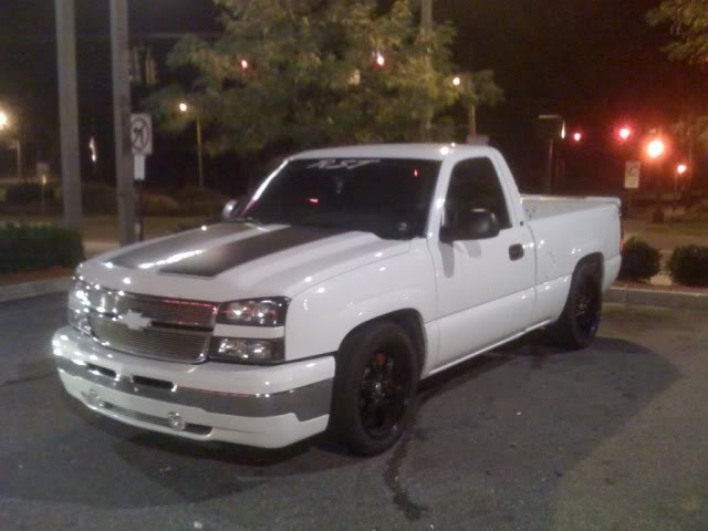

Did they make white with black stripes? didn't see it listed but saw this members truck.

Old Jan 2, 2012 | 01:12 AM
  #1960
RED04REGENCYRST's Avatar
Joined: Feb 2006
Posts: 983
From: monee, il
Yea, that is a legit RST. In 05-06 regency make trucks other than the john moss edition.
