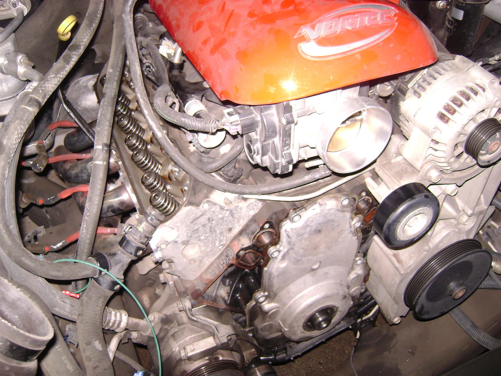

Old Mar 19, 2011 | 09:06 PM
  #1776
RSTinOKC's Avatar
Joined: Feb 2008
Posts: 383
From: Oklahoma City
Looks like surgery to me What the f are you doing to it?

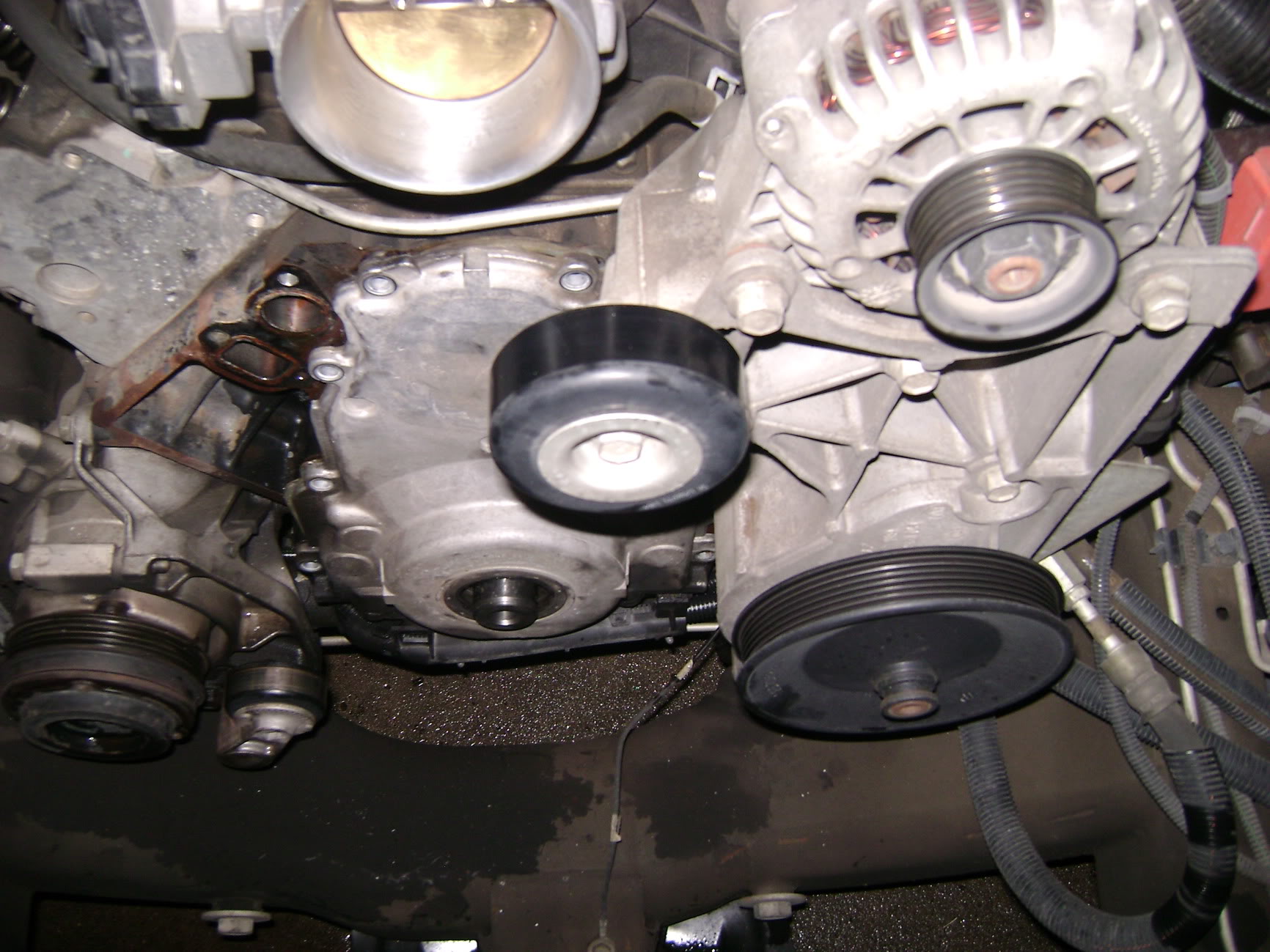

Red, I never got to an exhaust clip but if all goes well I will have one up by end of day tomorrow sporting the new cam.
edit: Here's what I have so far:

Got a set of 799's milled .030" and a 225/229 .583/.583 111 lsa.

Nice! I have a set of spare 862's sitting in the back room...I'm hoping to send them off for 2.02/1.575 milled .030 the works late this year/early next year.
The 799's are off L92 right?

I believe they are only on the nnbs 5.3.

Very cool...799/243 same same right? Thats the bad thing about the 4.8...no way to get good CR from a simple head swap.
