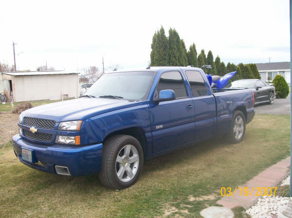

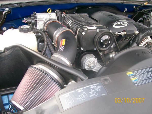

Now, his truck has the whipple with all whipple electronics, babyback system, and he wants to eliminate it, how fast would his truck be with nelson tune and bigger injetors, his truck is an 03silverado ss with only 15,000oringal miles AWD

what will it need to take the whipple electronics off, cuz it has the 2 injectors also connected

in order to eliminate the whippletronics, you need large injectors ( the 8 stock ones) and a custom tune, either mail-order or dyno/street
