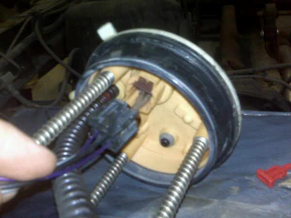

first get the sending unit out of the tank by removing the lock ring with flat head screwdriver and disconect fuel lines and plugs

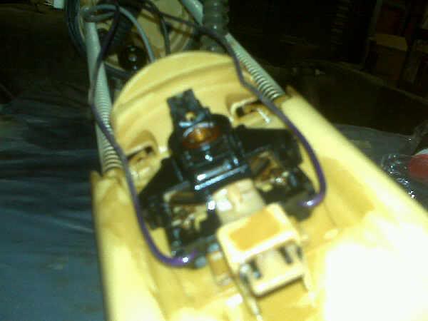

then i removed the float, so i didnt mess it up, its just snaped in plastic clips
then i disconected the plug on the underside of the sending unit and uncliped the wires from the the gas gauge float thing

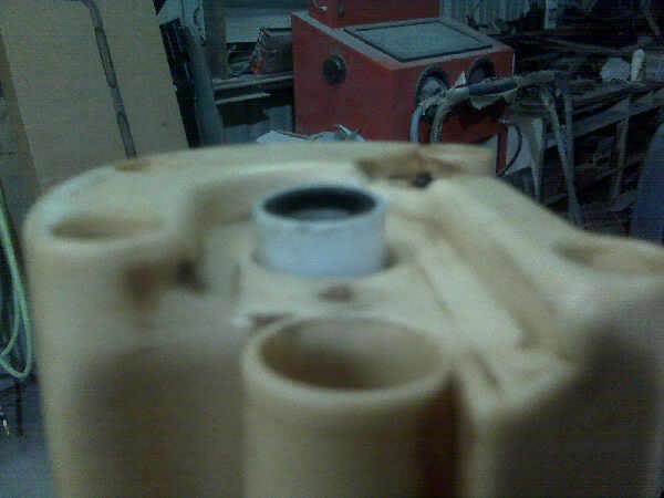

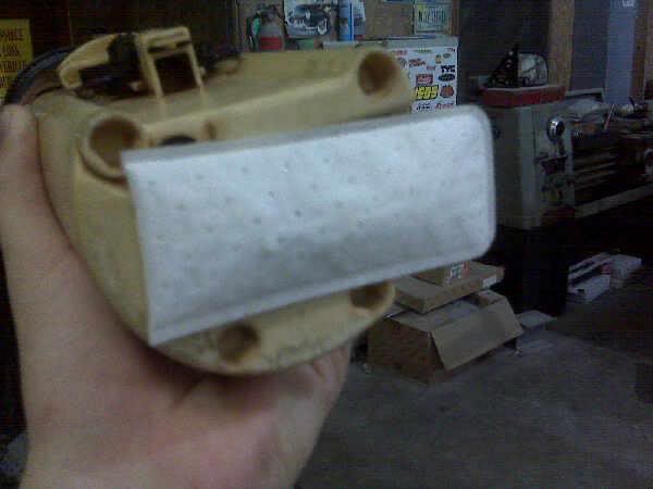

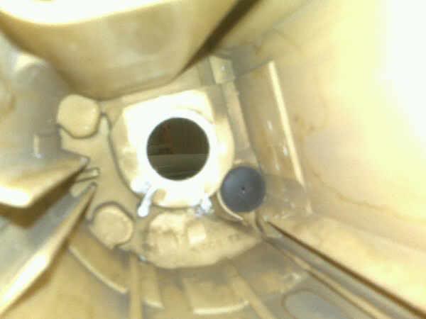

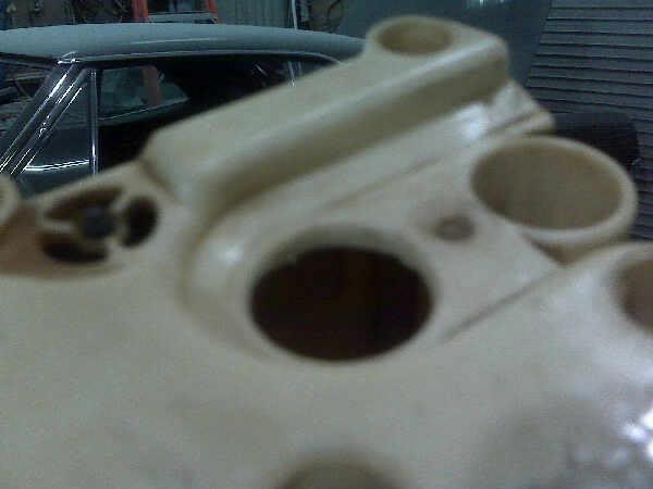

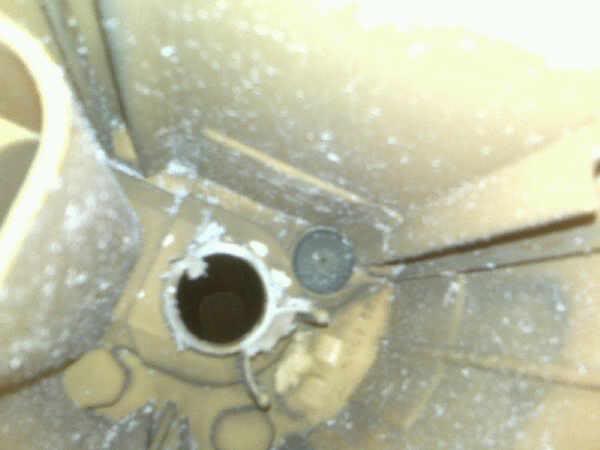

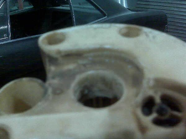

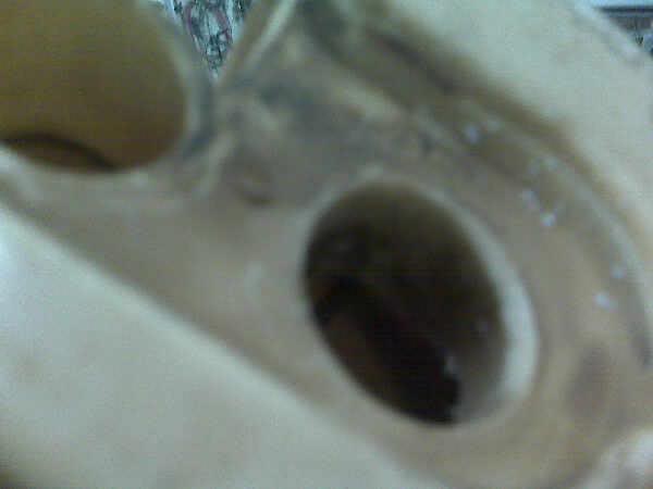

then i sepereated the bucket from the rest of the unit by the clips on each side, then disconect the pump harness and gas line on top. remove the sock filter and pull the pump out of the bucket and you will see a lip on the inside were the pump sat that has to be ground down for the walbro to sit down in for the sock filter to snap on
before
during
after

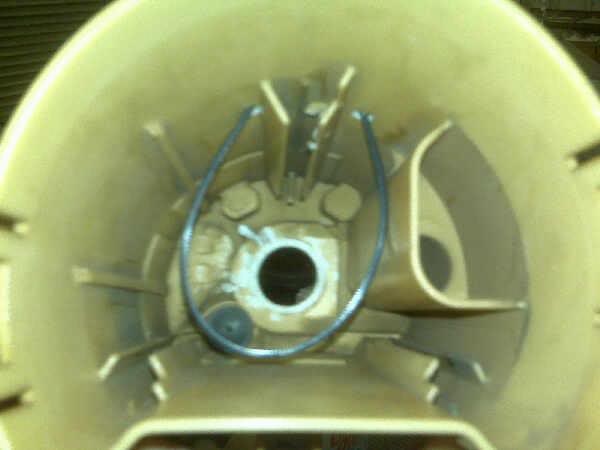

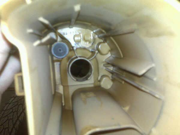

now the pump sits all the way in and the filter will fit on

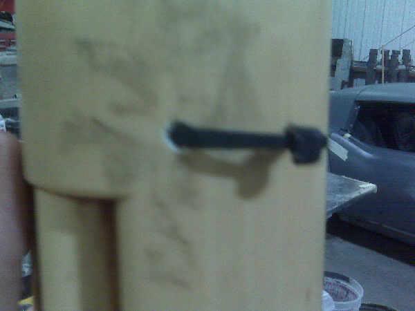

to hold the pump in i drilled 2 holes and ran a zip tie around the pump

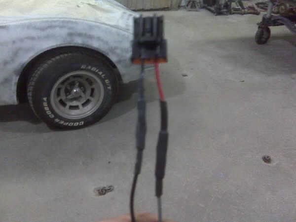

then i took the harness that came with the pump and the factory harness and cut and spliced them and heat shrinked them

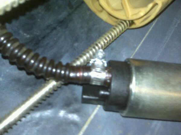

then put the stock hose on the end of the pump and pluged the harness back in and set it down in the bucket

Nice write up. Dumb question; is that plastic zip tie gas-desolveable?

no i used zip ties in my tank during my swap and its been about a year and they still look great. Havnt dissolved yet.

it should be fine.... i hope its fine i have one holding mine together lol
