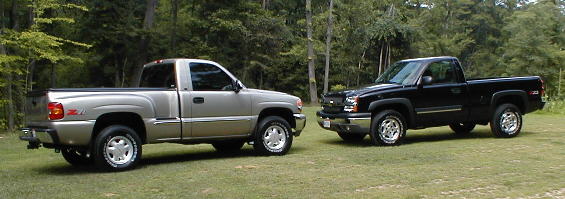

My Truck has way too much rake.
I Turned up Torsion bar a little but, I either take blocks out or drive around with
sand in bed to make it level.

rcsb z71 has like 4" of rake, they look real funny for sure.
