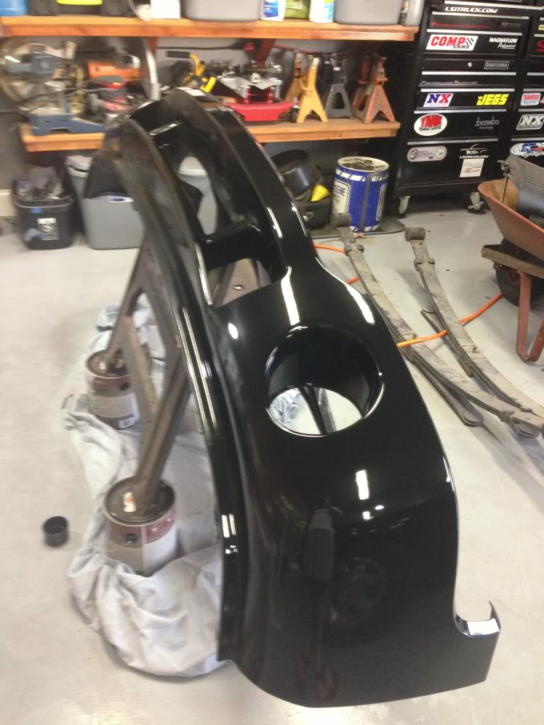

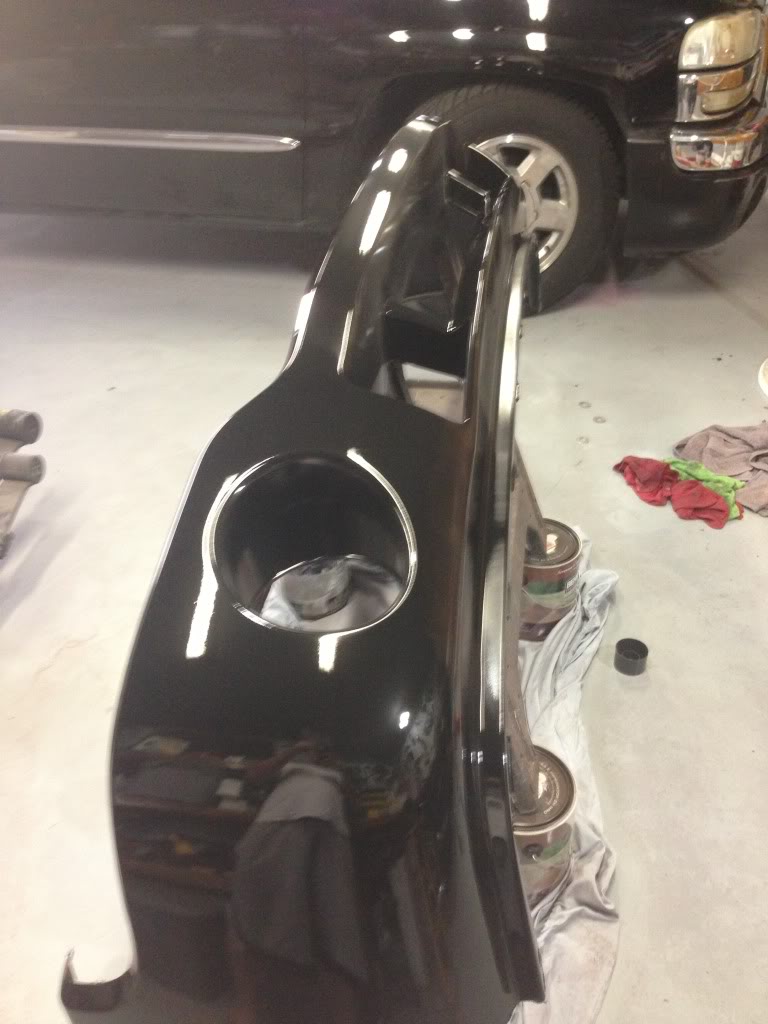

Garage paint job

Painted a a bunch of things in the garage. If you are on a budget, have no paint booth or a place that will get dusty, go with a nice single stage paint. You wont have to worry about a clear coat. Lay it down,wet sand and buff the *** out of it If you get a run, sand it out, buff it. It is more forgiving during and after it is done. Keystone makes very nice quality products, have had very good results using them along with Dupont and Sherwin Williams paints. PPG is $$$ and overrated IMPO. I am honestly considering doing my truck in a Single stage black.

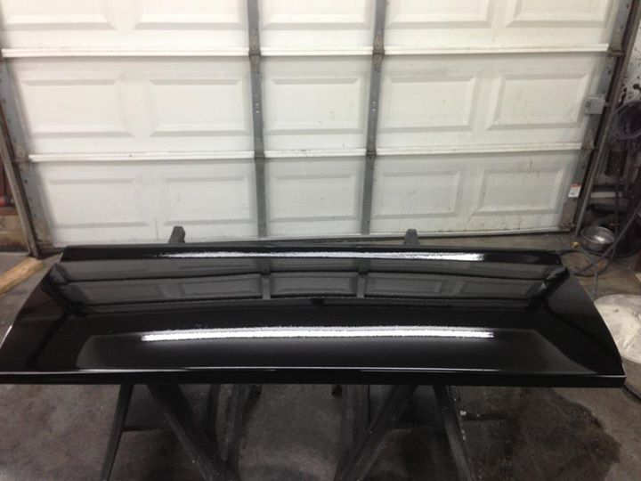

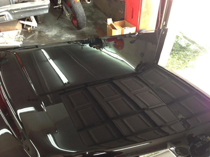

Few things that I recently did. Alot and mostly all is in the prep and primer/sealer coat. That will reflect the over all finish. Again if your looking for a budget I would go with single stage. You do not have to take the paint down to the bare metal. TRUST ME. Sand all the clear off, fix any dents, wipe the truck down, tac rag it, hit it with the primer.. My buddy just had a shop do his cab and front end. He pulled all the windows/rubbers out, got the truck back, it looks like ****. At a cost of 2k. needles to say they are doing it again. LOL
Attached Thumbnails Who has painted their own truck?-hd.jpg   Who has painted their own truck?-hood.jpg   Who has painted their own truck?-gate.jpg
