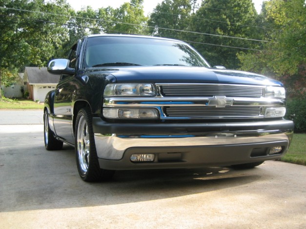

That would work too as it is a hair shorter than 245/40. Just curious, how does that size tire fit on the 8" wide wheel? Does the sidewall bow out any? I started to go with that size but really liked how my 245/40 fit the 8" wheels (isn't pinched or buldged) so I went with what I knew i'd like I wouldn't mind the extra width of the 275 though...that is for sure. If I had 9.5" wheels out back i'd be all over the 275/35
If it does, its just a little. Not very noticable to me anyways. I know different manufacturers sizes very a little too so maybe thats it. Anyways, this is the only pic I had somewhat showing the side of the tire. btw, they are Michellin Pilot Sports.
