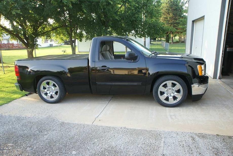

I took the 31.9" tires off of mine and dropped the diameter by 1.5" to get a better grip on acceleration. I am now running Nitto NT850 265/50/20 tires instead of the 275/55/20 tires and the ride is great.
