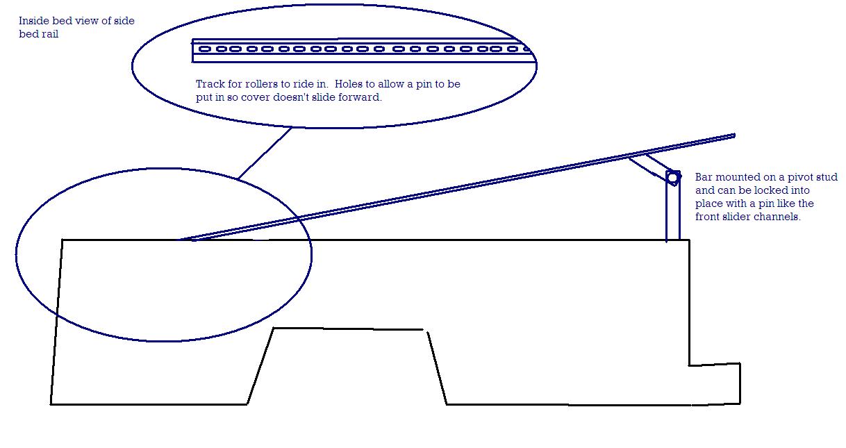

I'm followin y'all too I think, but instead of havin to cut it to swing open, you could just take and mount casters to the corners of the bed cover and have the slides for them to travel down mounted on the inside of the bed rails. That way the cover would open like this.

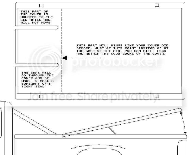

Cut you cover and have a piano hings installed behind where the bars go through it.
I wouldn't mind doing something like that, but this cover is super thin, and I'm not sure how easy it would be to cut it up. I had thought about going with a Checkmate tonneau cover and doing that, but trying to find a hinge and trying to figure out a way to make it seal would be the killer for me.
Another advantage of the cap....I could get one of those accordion looking boots that connect the rear window of the cab with the front window of the topper, so no custom lexan or polycarbonate windows.
I'm definitely open to suggestions, and the custom tin cover might just be the one. I'll have to look into that option further and see what some local folks could come up with.
Thanks for all the suggestions! Any pics you can find of trucks with cages and tonneau covers would be awesome!

Old Mar 28, 2007 | 07:59 PM
  #29
04BlackSilverado's Avatar
Joined: Jan 2004
Posts: 1,444
From: New England
That's what I was talking about
