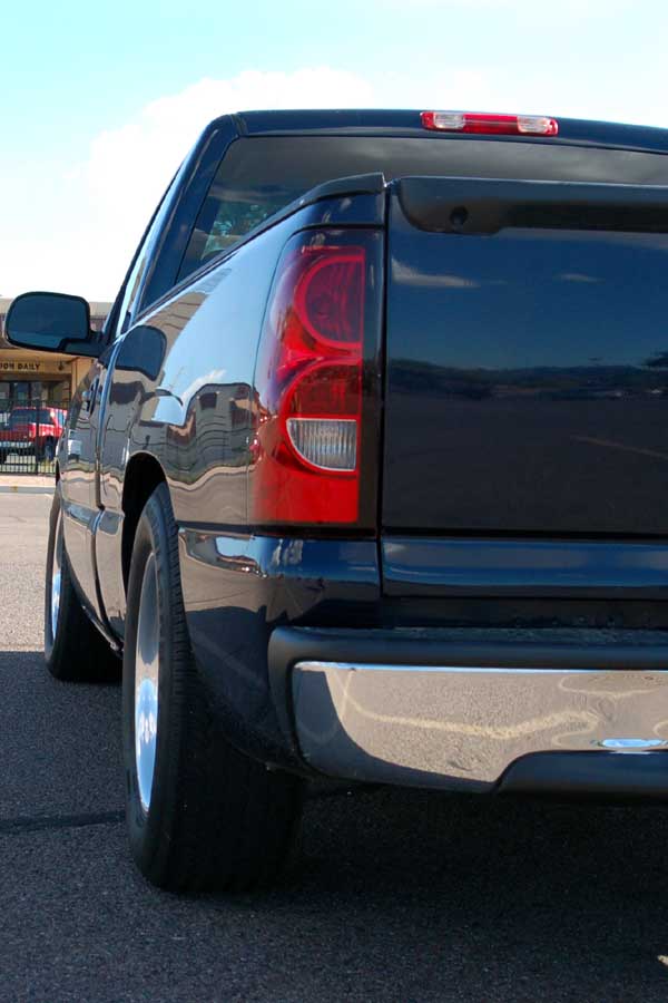

do you have another option for me, im running 265/60/18's which are on the tall side but not very wide. if i want it to ride right i would need to go to a smaller tire like a 255/60
i want a 275/55 which will be a little shorter, but not sure were that will put me i dont want to eat a tire

You may want to try a 285/50/18. When I first dropped my truck I had 265/60/18 which rubbed pretty bad up front. If you look back at my recent pic thread, that is what size tire is on the old 18x8.5 Moda R7. I never had a problem rubbing with that combo.

ok i was looking at that size, but didnt thought it was too wide, but i guess i need to lose the height, thanks bigkid, thats what im looking for, and i was wondering what was on your modas... ive been studying your pics
thank you!
