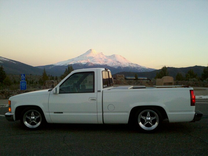

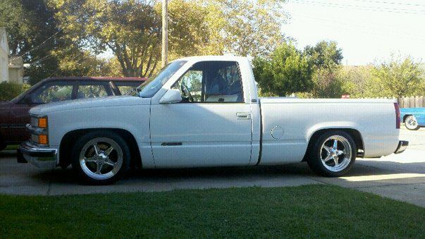

Beautiful truck! Simple, clean, good choice of wheels and I also like that look!
When my truck was put together in 1997.... 17s were considered big! I like the look of your 20s but, with the 5/7 drop on my truck, I have to choose tires carefully for the front (sidewall can't be too tall) as I only have a few inches between the top of the tire and the bottom of the inner fenderwell. In the right situation I'll rub the top of the tire on the inner fender. I have 235/45/17s on the front and 275/40/17 on the rear with 8.5" and 10" wheels. These 2 sizes of tires are almost identical in height and are about 26". At one time, I had a set of 235/40 series in the front and ended up damaging both front wheels on 2 seperate pot holes because there was not enough cushion due to the short sidewall. Had to send them in for repair and when returned, I installed a taller tire.
Good shocks make it a rarity now but, I don't think that I could run 20s.
Do you have that problem?

Thanks...I do not have any issues with those tires bottoming out on the inner fenders. When I run my stockers with a 30" tall tire, I have rubbed on dips in the road at a decent speed. With that said, the front is now about .5"-1" lower and I haven't made much contact with the inner fenders either.
