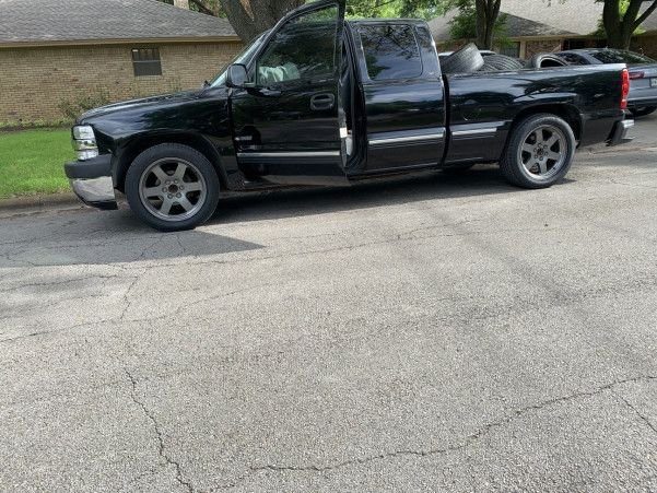

Alright suckas I am going to be finally taking my painted declads and polishing them tonight and this weekend. I actually finally had the gunmetal look grow on me but I still think it just looks out of place on the truck. I don't have any up close pictures of the wheels but those are them.
My plan is to sand with 800 grit on all four wheels to get the paint off, if someone has a different grit idea let me know but I don't really want to scratch the aluminum up too much if I can avoid.
Next is hit it with 1200 grit, then again with 2000 grit. From what I have been reading and watching this will actually give a decent finish before polish.
Lastly I will use my buffing wheel to run a white rouge over it and polish everything out. This should work and I hope I am not gonna look retarded afterwards. Worst that can happen is I have to sell the wheels for what I paid for or maybe $100 more
I do not have a sealant which is kinda in the back of my mind but I may just run a paint wax as a temporary solution until I can get something else. I really just need to sand once thank god, polishing is not so bad it is just the sanding 3 or 4 times that is AIDs.

If it is paint, not powercoat, use aircraft stripper to remove the coating. That will save a bunch of elbow grease trying to get to a polished finish.

It is paint, the guy used uno cards to protect his tire from his spray can and posted a pic of it when selling.
I was thinking about doing aircraft stripper but I'm worried about my rubber

Also I can peel some of the paint off with my fingernail so that is another reason why I know that it is paint and not powder coat lol

Do a test of the stripper on some old POS tire on the side of the road, if it bubbles or burns through the rubber don't use it on yours lol.

Wait a minute, I think I just realized these wheels are plasti dipped. I was reading something that says if it flakes with a finger nail it is dipped. That is exactly what mine does. This might be easier than I thought
Edit: Now I'm getting mixed reviews online about that lol I wish that guy sent me the can of whatever he used so I would know what it was. I only asked him about 5 times.
