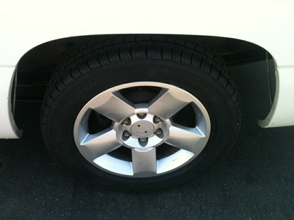

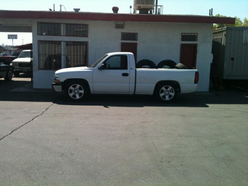

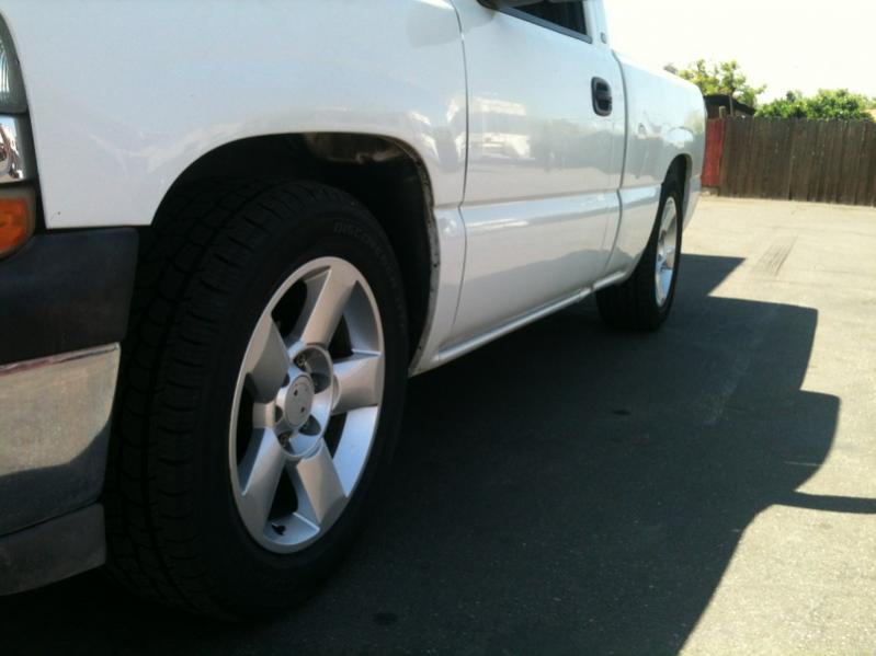

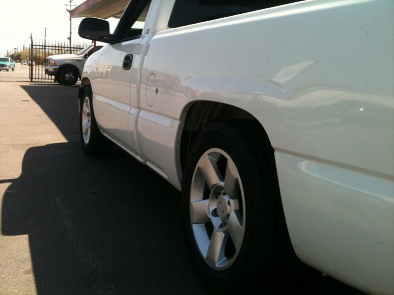

my new wheel combo silverado on titans
Old Mar 28, 2013 | 03:50 AM
LA FEA's Avatar
Joined: Jul 2012
Posts: 37
From: Kern
Default my new wheel combo silverado on titans
tire size is 255/55/18 on all four

What size drop do you have?
Old Jan 3, 2014 | 02:44 AM
LA FEA's Avatar
Joined: Jul 2012
Posts: 37
From: Kern
funny you ask it has v6 springs up front with one coil cut out
and the rear has shackles and hangers and they both have adjustment holes for diffrent hieghts rear shackles are at top hole which would be the lowest spot and front hanger is in lower hole higher setting the rear overload springs are removed also its realy close to a 2-4 drop. the suspension on the truck was done this way for a good reason and trial and error rides great and with the help of cal tracs and slicks it leaves hard at the track
