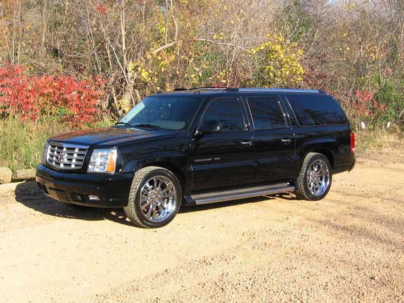

These are 22" wheels with 305/40 tires, with a 2/3 drop (spindle/coil)
The height should look about the same on your truck, I think its perfect for a daily driven vehicle. it can rub a bit, I think with 3/5 it would be even worse.
Sorry I don't have any better pics, this doesn't really show how low it is.
