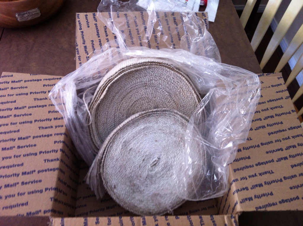

Check out what showed up in the mail today!
Thanks to Random User for the free hook-up!!
Gonna try throwing this on this weekend when I swap out the rear end. I have enough I think to do the front two cross-overs. Having those insulated should help a whole bunch!!
Thanks again Richard!

Damn that got there quick...I just sent it out on Tuesday.
USPS Flat Rate box FTW!
Soak it in water before you work with it. Latex gloves will be your friend too if you're sensitive to fiberglass. As you can tell it's pretty nasty stuff to work with. The soaking will help keep the fibers down and help it stretch around tight areas. Run the truck to let the heat dry it then spray it with that DEI stuff we talked about and it'll last a loooong time...if you decide to keep it on that is.
Good luck...hope it works well for you.

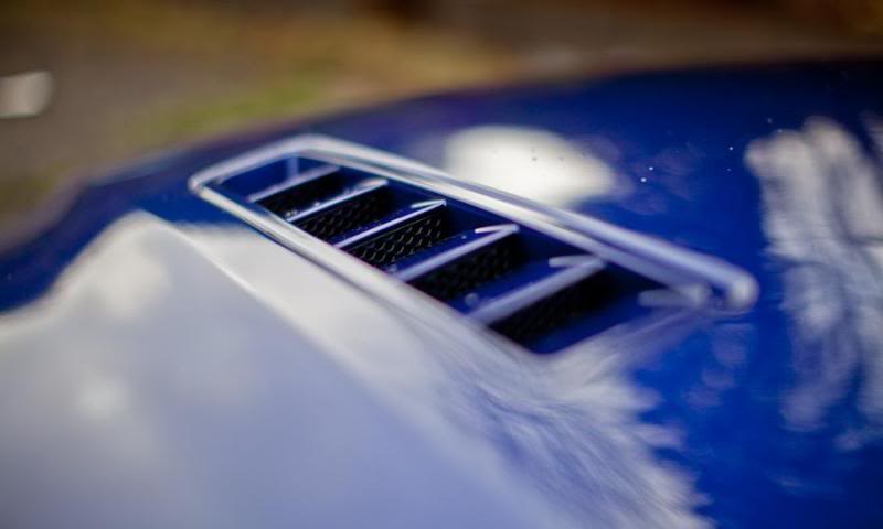

Hate to bring Ford into the mix, but what about the vents on the hoods of the new Mustangs? From what I read, they're functional.
