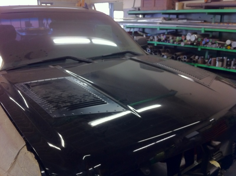

https://www.performancetrucks.net/fo...4/#post4916188
Old Sep 7, 2012 | 02:09 AM
  #23
Spoolin's Avatar
GFYS and STFU
Posts: 13,870
That's pretty sweet, never seen that particular hood yet. There's someone else who put the 07.5-12 NBSS style HD vents on his 03-07 Silvy. Can't recall the members name or the thread it was in.

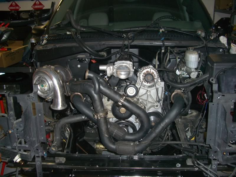

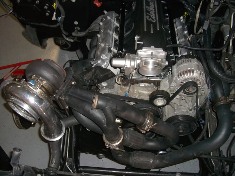

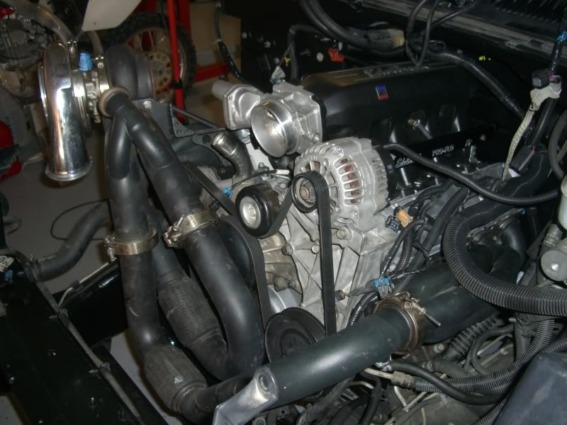

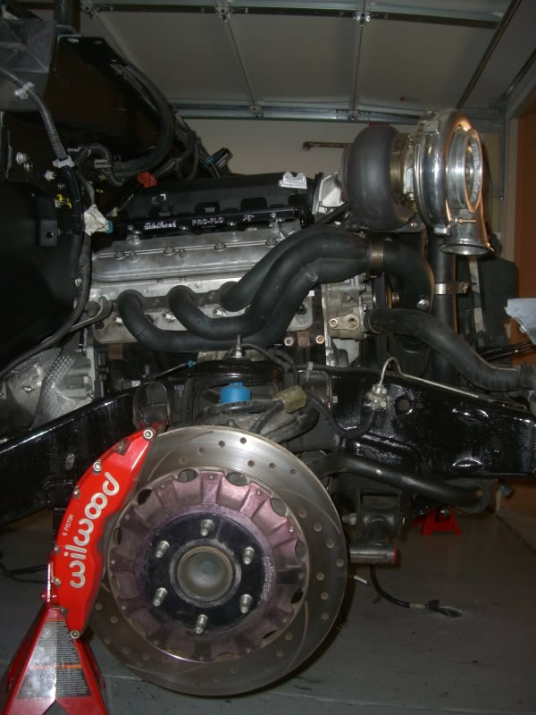

Here's the amount of hot parts that I would have to cover, it's really quite a collection of pipes, and this doesn't include the 4" DP that accounts for quite a bit of heat as well...
