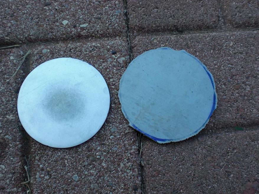

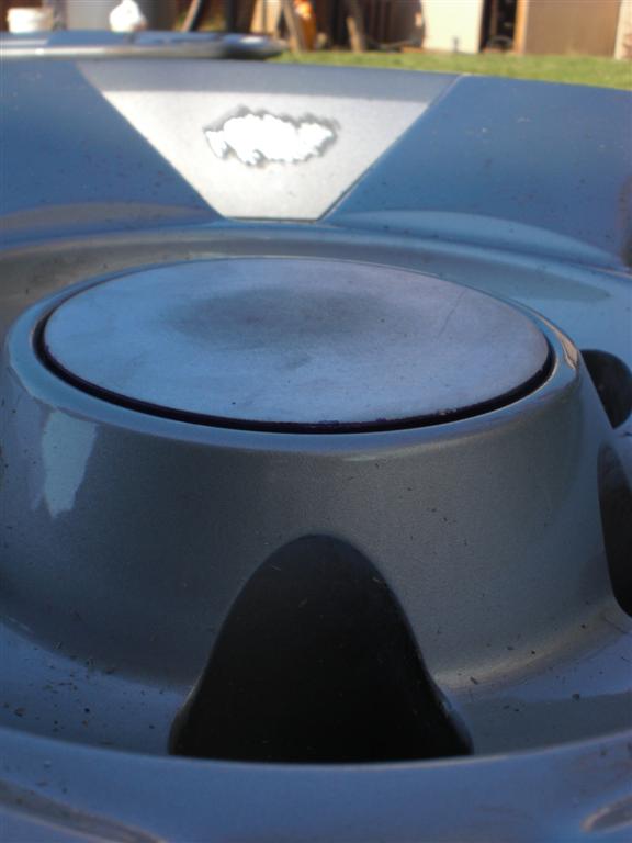

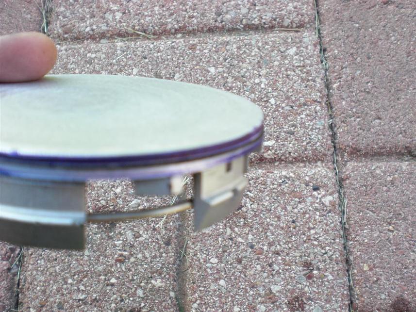

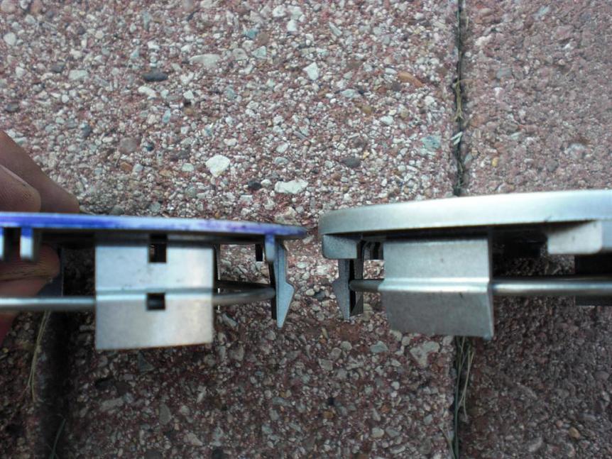

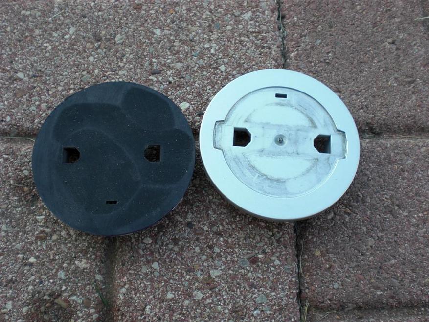

here is what i am going to do for my rims.
First i sanded down the center part until it was about half of the thickness.
Then, cut some 1/8"" aluminum to a rough circle then used a disc sander to sand it to just under the diameter of the center cap.
I am planning on powdercoating or painting the rims so i will epoxy the aluminum discs on after that.
