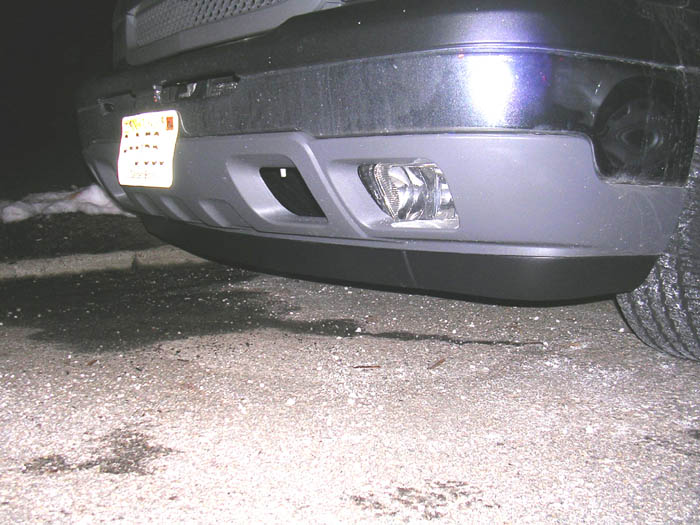

I installed one on my 04 and I love it, pn-10386198. That part number is for the 4x4 which is twice as big as the 2wd version (I dont know the PN for the 2wd version). However, you will need a lower valance (gray piece) from a 05 for it to mount up. When I installed my fog light kit it came with a new 05 lower valance, thus I was able to install the chin spoiler.
here's a pic
jeff

There are also "tow hook covers" that go behind the tow hooks to reduce wind turbulence under the hood as well as the extension piece. The 05 extension piece should fit on the 03-04 Silverado's with a little modding, Or get the 05 lower valance. I don't want to repaint the lower valance(mine is painted) so I would just mod it to fit.
One is left and the other is the right, not sure which is which.
10392478 -Tow hook cover 2005 Silverado's
10392477 -Tow hook cover 2005 Silverado's
10386198 -Lower bumper extension for the 2005 Silverado's (Correct # as above)
