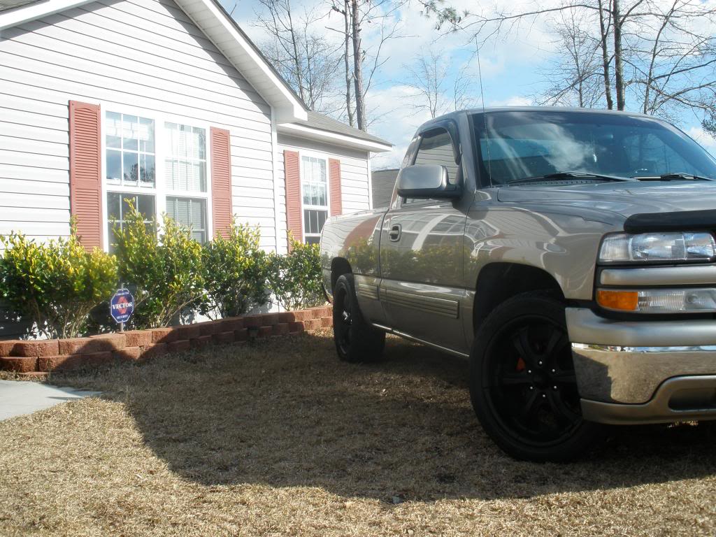

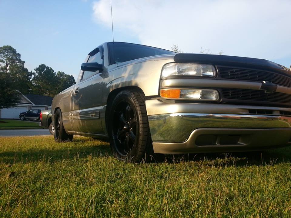

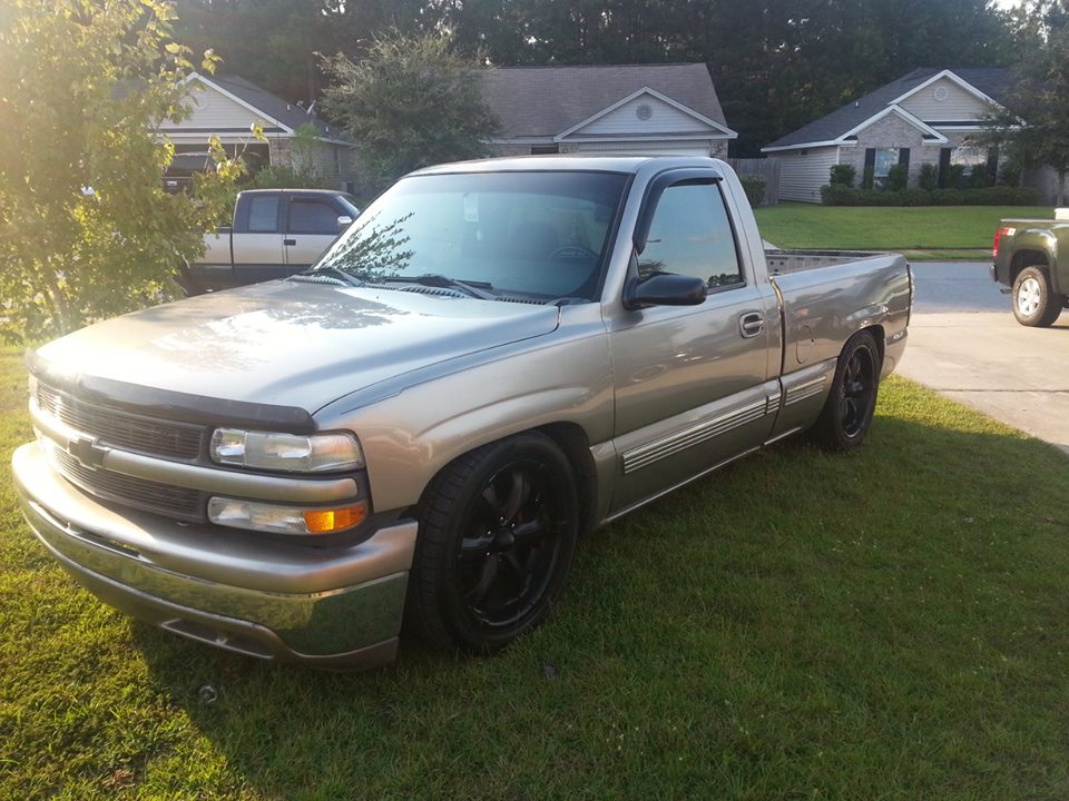

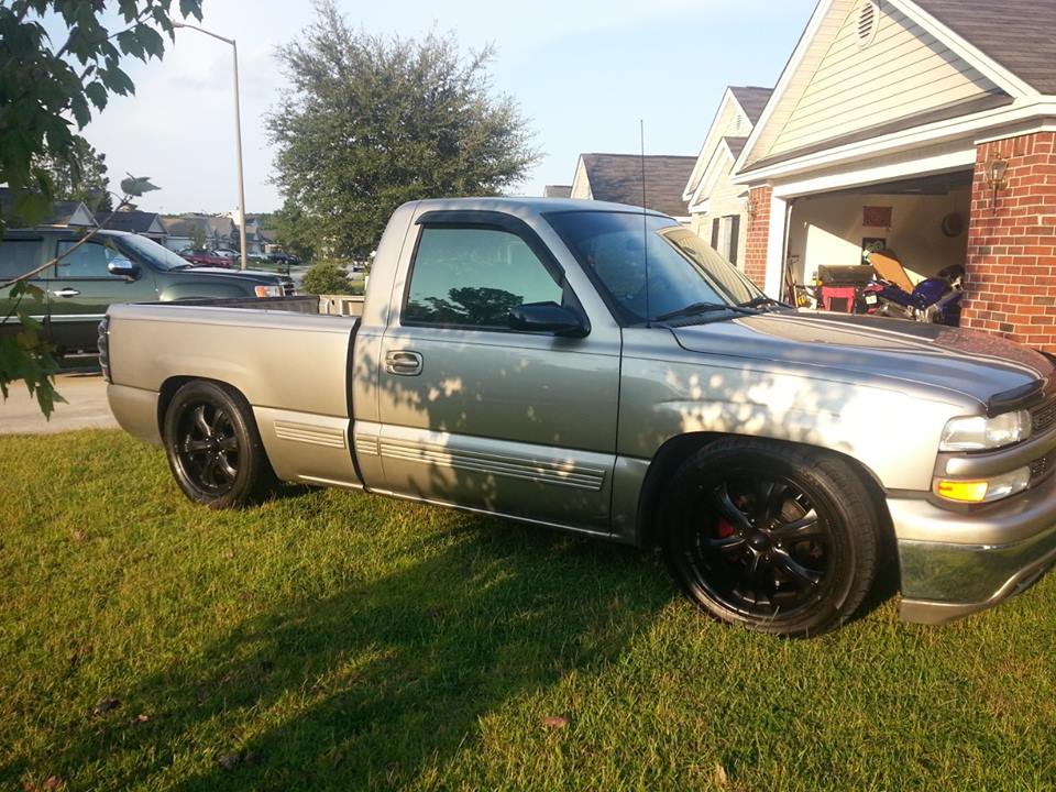

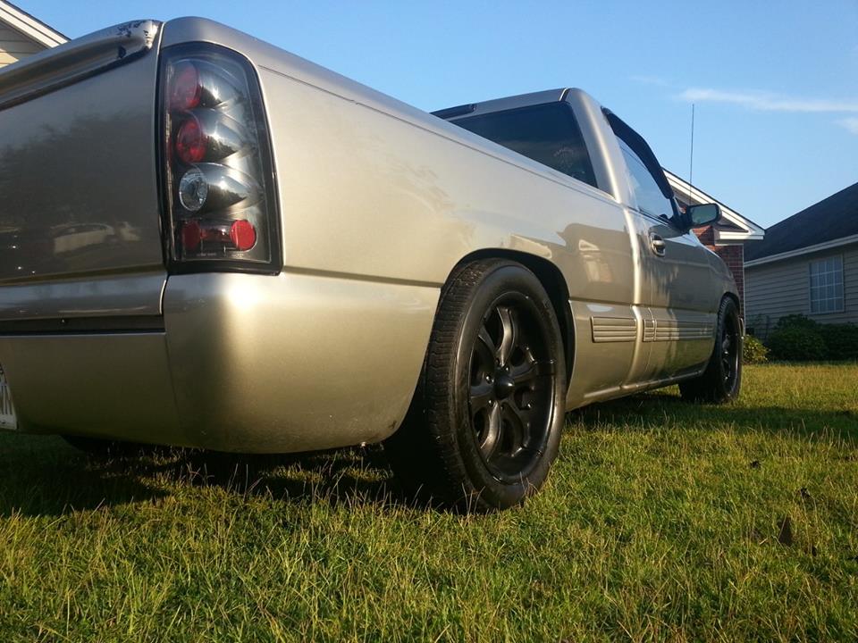

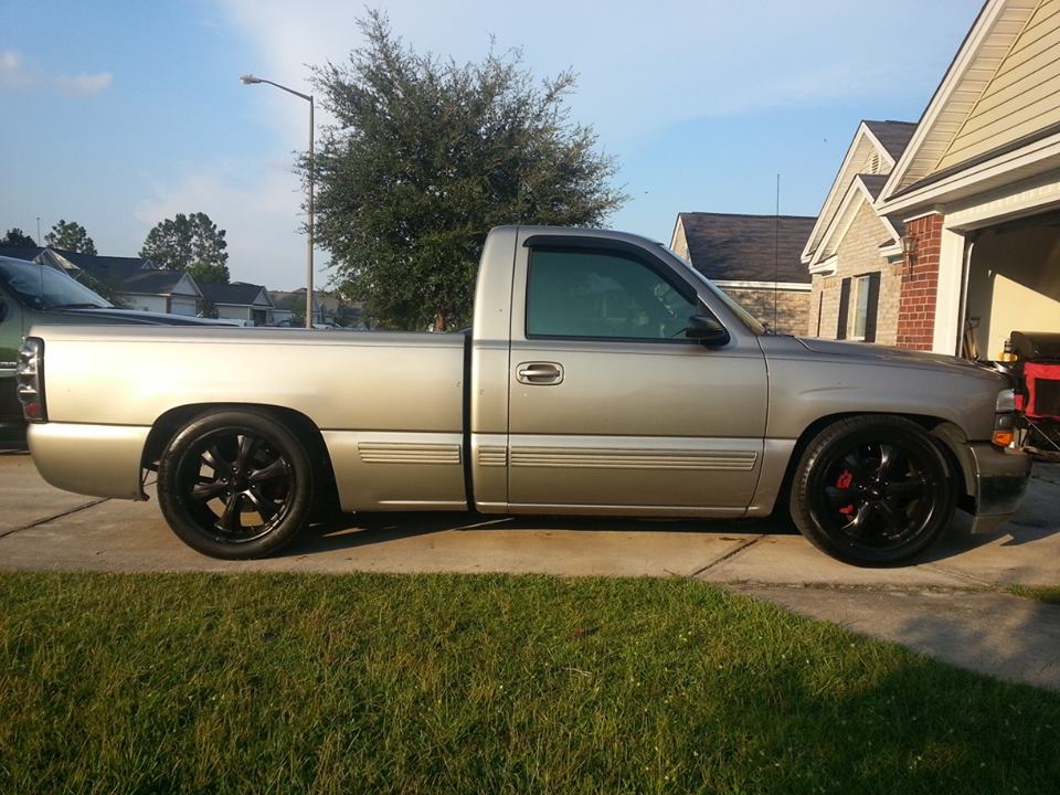

finally got around to lowering my wifes truck and it turned out pretty frekin sweet i think. its a 02 5.3 with 3:73's and exhaust. drop consist of 2" spindles, 2" springs, flip kit, c notch, and belltech street and performance shocks. only thing i cant figure out is why the rear end is a lil off center twards the passenger side and it rubs the finder on that side.
before pic

after

Looks damn good. Looks kinda familiar , maybe that is why I love it so much.

I'm digging it.

Looks good man your wife rocks driving a sweet truck like that.

Oh yeah, looks clean.

thanks guys. so after a lil research it seems like most chevy trucks the rear end sets about 1/2" twards the passenger side for some reason. guess im gonna have to flair the rear wheel well a lil.

Looks great! My only suggestion is raise the front bumper and close that gap up. Doesn't cost anything really and looks great!
