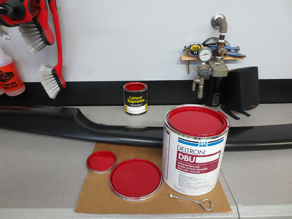

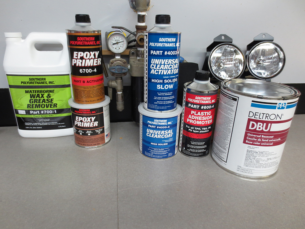

Paint supplies are getting ridiculously expensive. When I started painting in the mid 1970's the cost for the very best paint on the market was DuPont Imron at $36 a gallon. It was the first "activated" Polyurethane paint on the market. It was actually an aviation paint that made it's way to the automotive market. It's not much different from today's two part urethane clears.
Just the gallon can of PPG Deltron Victory Red basecoat is over $500. Then you add activators, clears, epoxy primers, reducers, sealers ect. you can understand why a good quality paint job is around 5 grand nowadays... with minor body repair!
