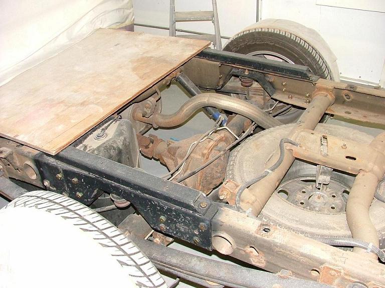

I just put a ART bolt in C-Notch in my 00 GMC ECSB and I love it. I lowered it 4" and it constantly bottomed out on the pancake bumpstops and drove me crazy. They are around $230.00 from ART but I found one on the fourms for $115 shipped. It wraps the frame and it has a 1 1/2" X 2" 1/4" wall tube along the top, strong as hell. Very highly reccommended. See attachment.
LK
